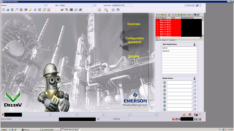

  • In reply to mdevienzio:
    You may be able to tell computer to run the monitor to run at 1680x1050 in which case it would just stretch the image to fill the monitor, otherwise above is what a single monitor DeltaV Station looks like at 1920x1080

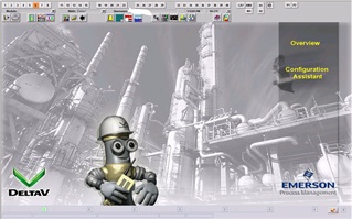

    You control the picture with the "Layout" file. The example uploaded by Mike utilizes the default DeltaV layout which attempts to preserve the 4:3 aspect ratio and throws in the picture history/ faceplate history / alarm summary which we did not find particularly useful.
    Also in Operate "user preferences" select the "Disable Auto Scale Feature" in the "Picture Preferences" tab (check the checkbox).
    Our layout file utilizes the entire 1680 pixel width for main picture. You can see old Duncan is stretched a little. The template for 1680 x 1050 is found under "templates" in your PIC directory.
