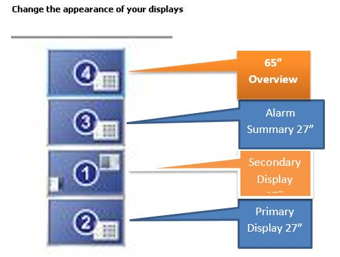

  • In reply to Matt Stoner:
     Matt, thanks for the reply.
    Thinking this will make navigation a little easier for the board operator, I am trying to get this to function. I think they will have an easier time finding the mouse.
    Primary / Secondary, whichever the order, I want these to function like their current dual monitor vertical workstation.
    The 3rd monitor "above" the secondary display would have the alarm summary.
    The 4th would be a large screen overview graphic.
    1.) Do I have the screen order correct?
    2.) The "DefaultVertical_1680x1050.Layout" only defines the primary and secondary screens (11 pictures which includes the history lists). Can I use the definitions for USER1 and USER2 from my quad layout file (which now largely works, thank you) and paste them into a new one for the 1x4 vertical layout?
  • In reply to John Rezabek:
    I'm checking but I don't think 4 displays is supported in vertical arrangement...give me some time to check but if it was supported it would probably be either 1,2,3,4 from the top or from the bottom (switch 1 and 2).
    I get the mysterious "error 9 - subscript out of range", but if you find the error in the Windows application log it tells you that the screen arrangement is not supported - so I guess 1 wide by 4 high is not currently available . . .
    That was my suspicion but I see comments that say "up to 4" in the reading of the layout file logic but that doesn't mean much :D
    If I had a system I would check but unfortunately I don't have one that I can use.
    I was trying to find the KBA that calls out the valid layouts but couldn't find it. The only valid 4 monitor layouts are the square and horizontal line. The only valid 3 monitor layout is horizontal line. We've had sites ask for odd layouts before but they aren't supported by DeltaV.
