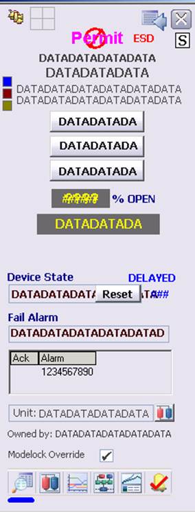

  • This sounds similar to the operation of an MOV (Motorized Valve), we have the same AI position indication, however, we use three buttons.  OPEN, CLOSE, STOP.
    The problem with your scenario is tracking an event when the button is continuously pressed, you would have to do some special code on the faceplate, behind the button while the mouse button was pressed.  Using three buttons eliminates the special code and you can just use a DC block with passive, active 1 and active 2 states.  This is all standard stuff and will give you less hassles when troubleshooting.
    Hope that helps.

  • That’s exactly the issue I was referring too, we use a similar case for an MOV with the following FP.
