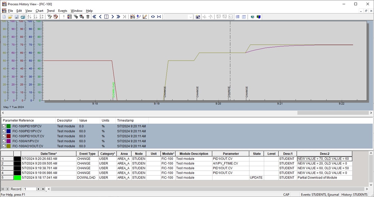

There used to be training that indicated the M Series AI cards had a 65 ms anti aliasing filter. I have a time sensitive application using CHARMs and it will help with the design / simulation to know what the corresponding filter time constant is for CHARMs.
