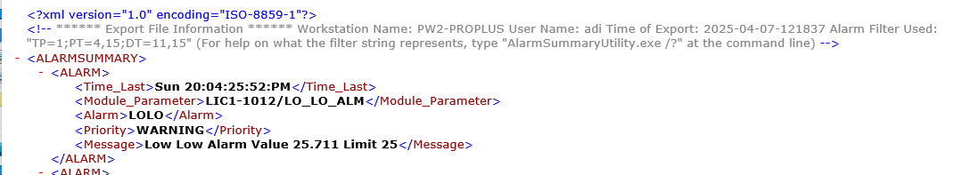

Would anyone know if it is possible to change where the alarm summary is exported to? The default path when using the export alarm summary to XML tool is D:\DeltaV\DVData\AlmSummary_export I would like to change this path if possible.
Thank you in advance.

  • Unfortunately, no such option at this point.
    Note that you can script this export by using AlarmSummaryUtility.exe and them move the file afterwards.
    AlarmSummaryUtility 10 TP=1;PT=4,15;DT=11,15 2 16,2,10,14,3 1 0 "W h:m:s:F:p" /export /silent
    move C:\DeltaV\DVData\AlmSummary_export\*.xml c:\tmp

    Just a quick check, clicking on Export Alarm Summary to XML uses the following:
    AlarmSummaryUtility.exe 10 TP=1;AB 1 1,18,20,2,6,10,23,3,14 1 1 "W h:m:s" /export

    Alarm Summary (e.g., AlarmList) can be configured offline (DeltaV Operate Configure mode), user can add/remove colums. The expport functionality exports columns as configured for that control in DeltaV Operate.
    Now the command line parameters change accordingly if you change columns. The easiest for me to figure this out is to use Process Explorer, for example I changed my alarm list to only show the first 4 columns and the command line changed to:
    AlarmSummaryUtility.exe 10 TP=1;AB 1 1,18,20,2 1 1 "W h:m:s" /export
    But really, the columns fields are specified in the 4th argument - 1,18,20,2
    AlarmSummaryUtility /? shows the option, so
    1 - alarm state (1=ACT/ACK, 2=INACT/UNACK, 3=ACT/UNACK
    18 - time of occurrence (hh:mm:ss)
    20 - unit name
    2 - alarm Id string (<moduleName>/<alarmParameterName>)
