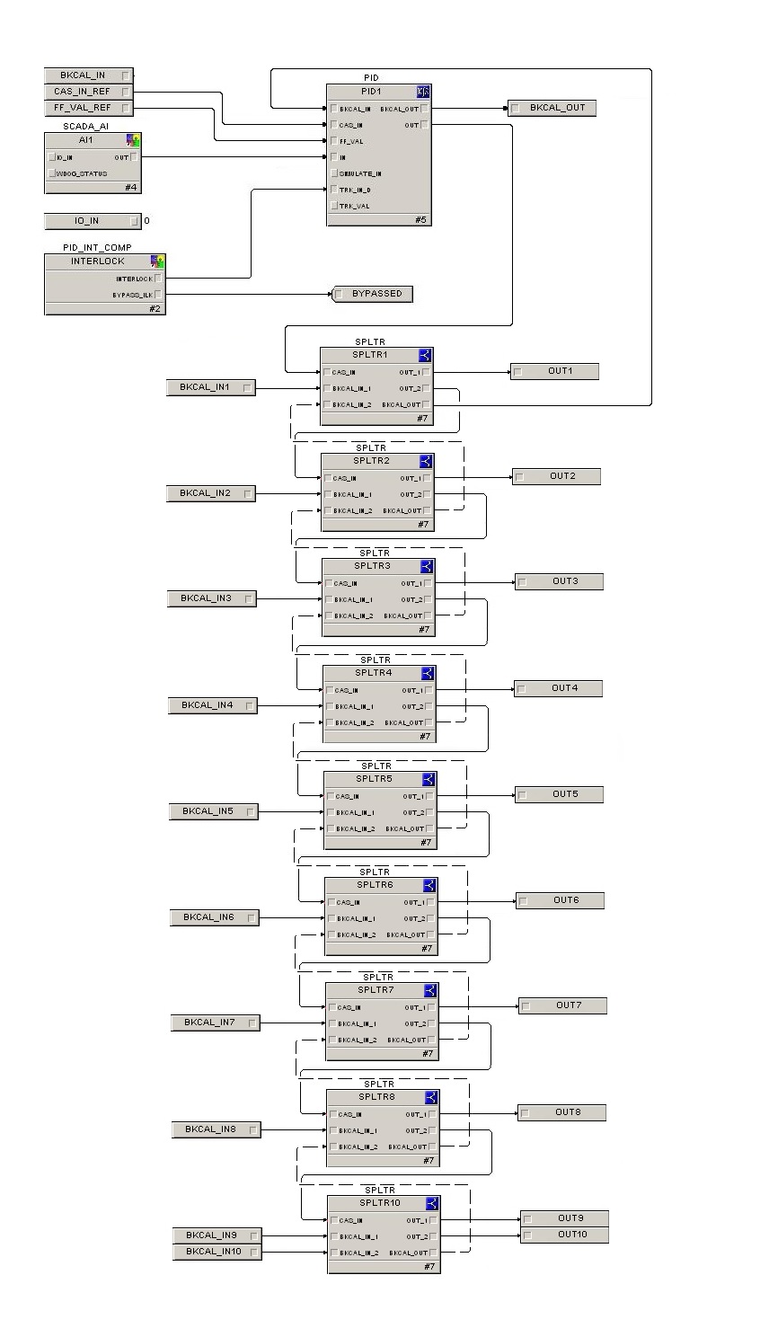

May I know what is the best approach in controlling 10 valves simultaneously using only 1 PID controller?
Can I use 9 splitter blocks to cascade the signal to the 10 AO blocks of the 10 valves?
Or is there a better approach other than the splitter block?

  • This is what I did. The OUT of each Splitter will be connected to the AO. Then the Bkcal_out of AO will be connected to the Bkcal_in of each Splitter.
    Is there any other Function Block that I could use to simplify this?

    One of the problems with the way your back calculates works is that, as Andre pointed out, it takes multiple scans before the back calculate from some of those outputs will ever get back to the PID block.  In the case you show, it will be 10 scans before BKCAL_IN9 or BKCAL_IN10 get back to the PID.  If you layer the splitter blocks, as shown below, it takes no more than 4 scans for BKCAL_IN1-4 get back to the PID1 block and 3 for the rest.

    As Andre said, you may want to simplify this by computing your own back calculation to the PID rather than run through all of these splitters.
    The other thing I noticed was that you have the interlocks tied to to PID.  I assume each of these outputs might be on different lines where there might be different interlock conditions tied to each line.  If that is the case, you may want to set up interlocks for each of the AOs instead and let the backcal tell the PID if all if them are interlocked or limited or in the wrong mode.  If they really do all have the same interlock conditions, never mind my comment.

    If in case one of the valves goes into IMAN or OOS, will this configuration affects the other valves?
  • In reply to Rein:
    Can say in both approach, your serial or Garelds parallel (which I also prefer), a valve not in CAS mode will not affect the PID or other valves, because you get always on the second input another good BKCAL_IN value. What it means for your process is another point. Since you don't show a process flow diagram, no one here can imagine how that control (Flow/Pressure?) shall work.

    Thanks for the configuration example Gerald, that is what I was thinking.
    As long as there is one good BKCAL connection, the PID will remain in its target mode. The flip side is that if for some reason you have all the AO blocks in a mode other than CAS, and you then place one in CAS, the PID will align with that AO and transition to the TARGET mode, and as you bring other AO blocks to CAS, they will ramp to the defined control signal based on the Splitter blocks ramp rate. For your application, with all valves 0-100%, things will work rather predictably. In a split range application, if you bring on the upper range valve, the PID can synch to an OUT value of 50% to 100%, and when the lower range valve is placed in CAS, it ramps to 100%, because that's what it does and you asked for it.
    The point is that you have to carefully consider the abnormal operation conditions. As in with most complex strategies, the error handling can quickly become more complicated than the primary control scheme. The BKCAL mechanism is intended to facilitate synchronization of upstream blocks (PID) to downstream (AO or SPLITTER or PID for example). With 10 parallel downstream blocks, maybe you don't have to worry about this via BKCAL.
    - Will you ever operate this control loop with all 10 loops out of CAS? If not, then the BKCAL synchronization will never come into play. Why worry about it.
    - What if all 10 AO blocks go to IMAN due to loss of communication with the IO card(s). Very unlikely, but you would want to prevent the PID from winding up, especially if you've configured the AO blocks to hold last value. You can use the Track feature of the PID to handle any abnormal conditions, like, set a minimum number of Good AO signals to allow the PID to run in Auto. If the number of AO fall below this, you can force the PID to MAN and hold the output, letting the Operator still control the remaining valves' positions. Or if no valves are in CAS, force the PID to track to 0.
    - what other conditions do you have to consider? Hmmm.
    It's hard to imagine that a PID loop would operate adequately with one AO block if it was tuned with a process response from 10 AO signals. And vice versa. You might need some gain scheduling based on the number of Valves in CAS.
    You'll need to consider all this, and keep in mind that the Splitter function will keep the PID in AUTO even if only one valve is in CAS. I would say it was not designed for such an expanded array of Outputs, so it may not be the right solution for your problem.
