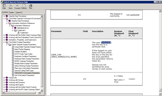

    Well it's not everyday I can add to an answer that Andre has given so I'll jump on this opportunity ;-)
    If you don't want to parse the user.scr file, here is an easier option. In operate you can use "THISUSER. " to get a whole bunch of information, a few that are particularly useful in this case:
    1) THISUSER/USER_CAN[AREA_NAME][LOCK_NAME] .F_CV
    "The user (THISUSER) has the key to a particular lock. If the logged on user does not have either the key or the key for the area specified, the parameter returns False (0). Spaces are not permitted for area names or lock names"
    2) THISUSER/IS_ADMIN_USER.F_CV
    "The user has admin privileges"
    3)THISUSER/CAN_INSTALL.F_CV
    "The user has Install privileges"
    4)THISUSER/CAN_CONFIG.F_CV
    "The user has configure privileges"
    5) If writing a script, you can use frsUserConfigPrivChk ( ) which will return a Boolean if the user has config privileges.
    There are additional parameters that can be set/looked at by opening the "DeltaV Operate Pictures Help" (Open the animation wizard and click help) and searching for "THISUSER Workstation Parameters"
    So one idea is that if you have any unused locks, you could use that to give users "full graphics access" and look for that key once a user logs in and change the picture navigation strategy.
    Good Luck!
