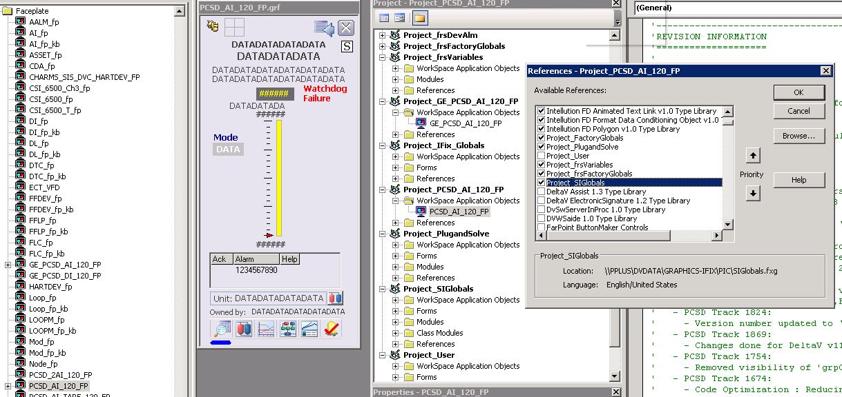

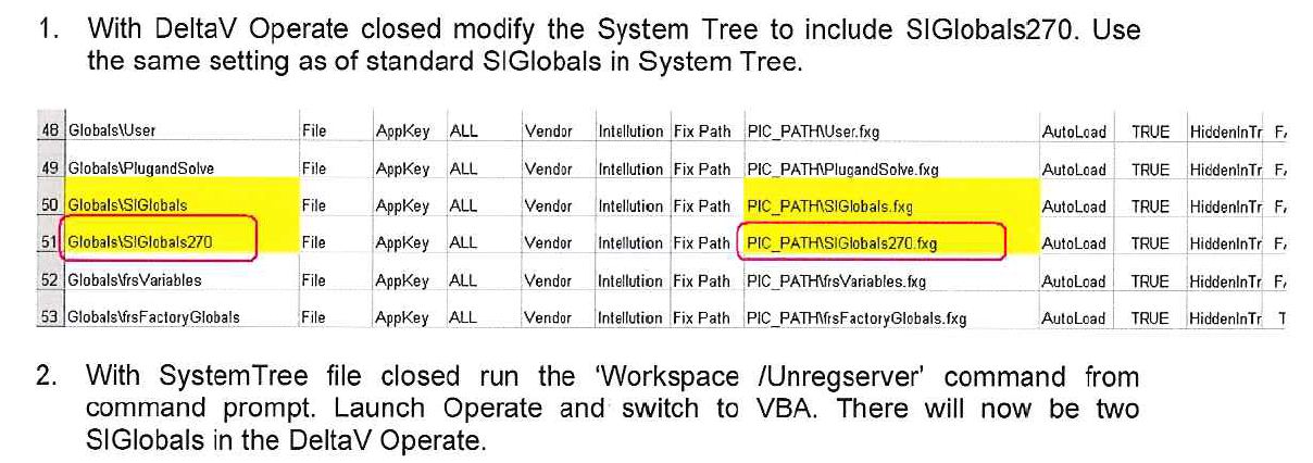

   The goal is to have 2 new SIGlobals (SIGlobals01 and SIGlobals02) with the same content from the original and customize according to the requeriments from costumer. I've created a new SIGlobals using the attached procedure and the NA-1000-0003 to copy the color table, but I couldn't copy the treshold table and other variables.

    You can just copy the original SIGlobals file, rename it and then modify the system tree file.
    The problem that you will have is that it will be difficult for you to control which set of code executes if they do have the same items within them.

    The goal is to be able to use the standard and a customized PCSD at same time (few differences from the original for different faceplates, i.e.) this is a requeriment from costumer.
    Is there any special way to copy the SIGlobals? I tried copy&paste, but is doesn't appear in the system tree or in VB in DeltaV Operate Configure mode. And if I follow the procedure I sent before, I cannot get the treshold tables and variables, only color tables and forms could be imported from the original.

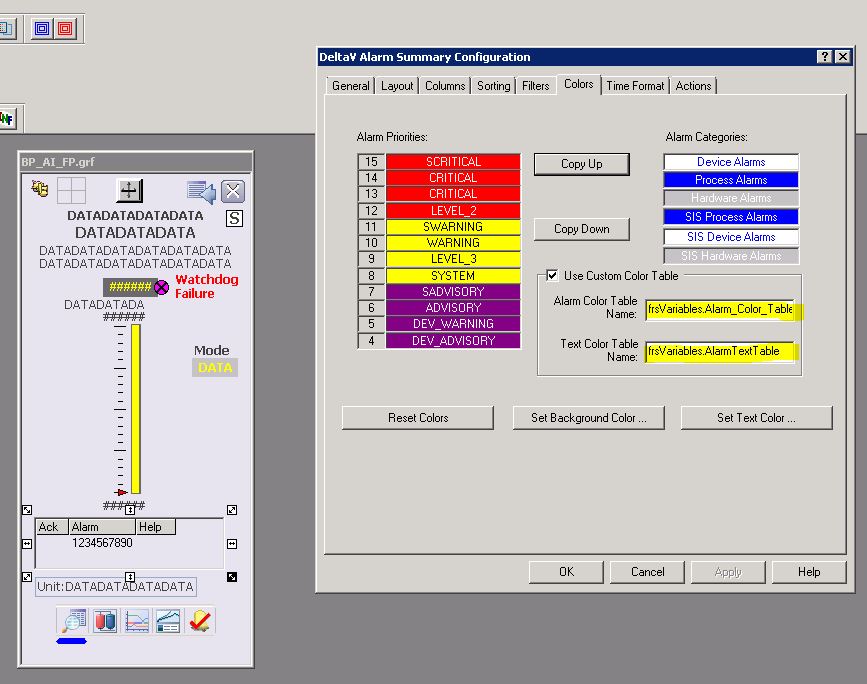

      I have the original PCSD_AI FP and X_PCSD_AI FO (which is a copy from original). Inside the X_PCSD_AI FP, I've changed the VBA code to use the USER (replaced all SIGlobals to USER) and also changed the reference to use USER (unchecked SIGlobals). I made changes in the USER color table to be able to see the difference on FPs, but when running DV Operate, both FPs (original and X) have the same alarm colors.

    Did you double-click on the alarm activex control and change the color table there as well?
