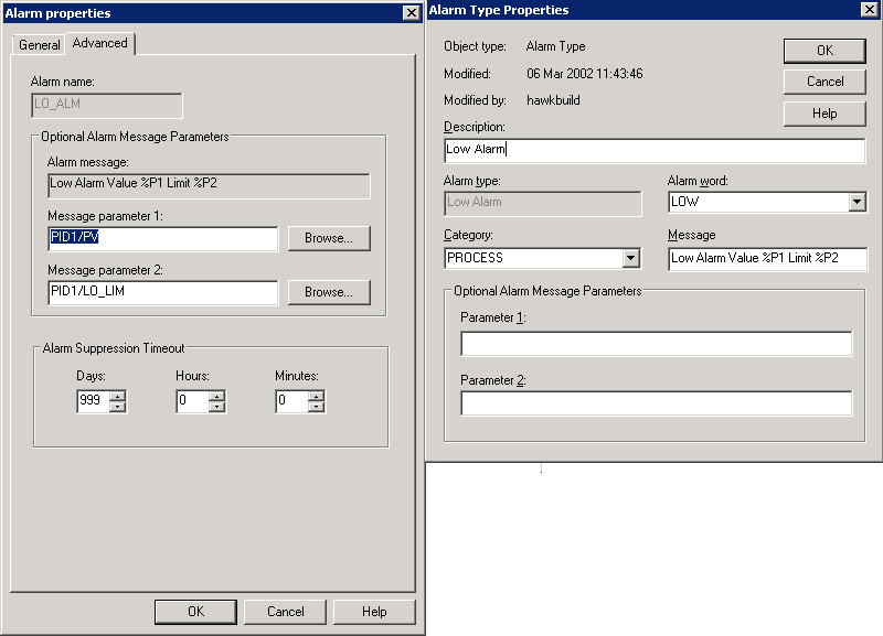

    I set up the Alarm as shown above in your example. However, I can not see BFI1/FIRST_OUT in event chronicle. I assummed the BFI1/FIRST_OUT value will be displayed so I can see what condition caused the trip at that instant.
    Thank you
  • In reply to Youssef.El-Bahtimy:
    Youssef,
    How do I add alarm limit column to the event chronicle?
    Thanks

  • In reply to DCS Newbie:
    Take a look at the PID_LOOP module template in the AnalogControl folder that comes with DeltaV.
    The configuration of LO_ALM, for example, shows that the Alarm Message (DESC2 in Event Chronicle) will be "Low Alarm Value %P1 Limit %P2"
    where Message Parameter 1 (P1) is  PID1/PV and Parameter 2 is PID1/LO_LIM.  (The alarmed value and the limit, respectively).
    The message format is configured in the Low Alarm definition within the Alarm Types in DeltaV Explorer System Configuration-->Setup-->Alarm Types.
    If you were to create your own Alarm type based on the new requirements, you would define the alarm message structure in the Alarm Type definition.  Reference that alarm type in your strategy, and configure the reference parameters for the value and limit for the instances accordingly.
