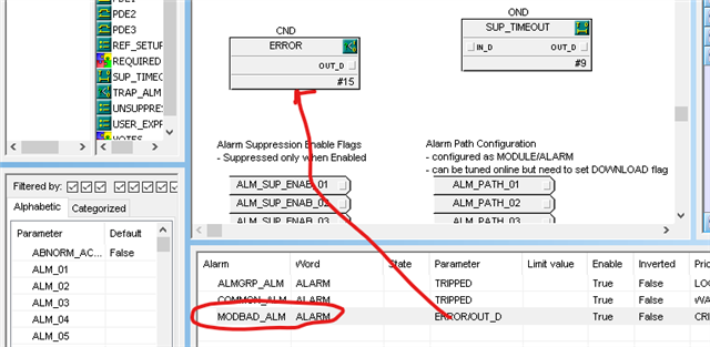

  • Can you please check how MODBAD_ALM was configured? This is how it looks like for one of the templates.

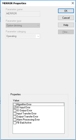

    If you have the same configuration as above, kindly share contents of the CND block. If it is tied to BAD_ACTIVE, can you please share values of MERROR when the issue occurs?
    Below is an example of a module with bad input.
  • 264 is IO Input Error and Function Block Bad Active (most likely the same input error).

    Ralph, it looks like you have a custom alarm called MODALM. You haven't explained what triggers this alarm. Is it based on module/BAD_ACTIVE? This is set based on the MERROR_MASK and MSTATUS_MASK, so it depends on your configuration. Or is this based on a CND block expression? It would be useful to know how this alarm is configured.
    If you want to condition this alarm, and it is based on the BAD_ACTIVE, you will have to modify the configuration. Adding a CND block to read the BAD_ACTIVE would allow you to condition the alarm trip, by adding logic or enabling the delay timer.
    The INPUT ERROR is the result of a BAD status on an input function block in the module. An analog input will go BAD if the incoming signal exceeds the max signal which for CHARMS I believe is 22.5 mA. Normally, transmitters are saturated below this (usually configurable) Enabling NAMUR limits would allow the channel status to be marked BAD but only if the signal reached the limit and held for 6 seconds. If NAMUR is not enabled , then this is not your issue. If the spike goes beyond 22.5 this sets the status BAD immediately, and if NAMU is enabled, it stays BAD until it crosses below the NAMUR limit.

    By using the CND block and its delay timer, you can modify this alarm to filter out a transient condition, once you know the duration. The BAD status would have to last x seconds before the Alarm tripped. You get to figure out what X should be. This would delay all Module Error transient conditions. Also, you need to include MStatus as it to may drive the BAD_ACTIVE and your CND/OUT would be replacing this as the Alarm trip.
