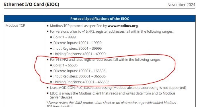

    Andre, We have a client hitting this situation again with a Fire Alarm Control Panel today (6 digit Modubs Holding registers), any update to EIOC firmware to support > 65,535 (FFFF) yet?
    Just checking.
    p.s. Thanks for your contributions to this forum.
    CHris
  • In reply to chrishoffpauir:
    Emerson announced that this is resolved in v15FP1 ( Im on FP2)
    This is not something that will be rolled back into v14LTS, as far as I know
