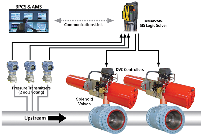

A two- or three-solenoid safety methodology enables online valve testing and maintenance, providing greater protection and improving uptime while complying with functional safety requirements.
Collectively, the SIFs make up the safety instrumented system (SIS).
An SIS typically consists of sensors, logic solvers or controllers and final elements. Sensors measure process parameters, such as pressure, temperature, flow, level and gas concentration. Logic solvers or controllers translate signals from sensors and complete preprogrammed actions to prevent or alleviate process dangers. Final elements, which include the ESD [emergency shutdown] valve and a pneumatic, electric or hydraulic actuator and solenoid valve, bring the process to a safe state.

Installing a second solenoid valve isn’t particularly time-consuming or even complicated. In fact, there is a prepackaged solution that uses redundant solenoid configurations. The redundant control system (RCS) is a proven pilot valve arrangement that provides built-in redundancy and diagnostics.
The ASCO Series RCS Redundant Control System can perform automated testing.
The RCS’s automated online testing, including solenoid valve and partial stroke tests, allows users to identify 98% of hazardous failure points with no bypassing, while pressure switches provide continuous monitoring and diagnostic feedback. When the bypass is activated, the RCS also makes online maintenance, such as replacing solenoid valves, coils and pressure switches, fast and easy with no process interruption.
Read the article for more on the various architectures, including 2oo2D [2 out of 2 with diagnostics to detect failure conditions], 2oo3, and 2oo3D, and how the RCS performs this testing in safety applications up to SIL 3. Mike also shares how the different architectures affect the probability of failure on demand (PFD) and spurious trip rate (STR) for the various architectures—1oo1, 1oo2, 2oo2, 2oo3, 2oo2D, and 2oo3D.
