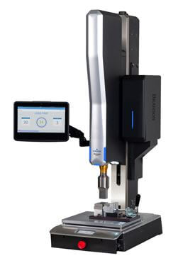

Ultrasonic welders, such as the Branson ultrasonic plastic welding products, provide:
…manufacturers with a high degree of flexibility through modularity of the tooling setup. By using a single ultrasonic welder and a range of part-specific tooling, manufacturers can produce a variety of different parts on a single assembly line.
These ultrasonic welders work by creating friction between the parts to be joined. The:
…mechanical vibrations are transmitted to the interface between the parts, where it is focused on a triangle-shaped bead, the energy director, which focuses the vibration to create intermolecular and surface friction. This friction creates heat and a subsequent melt, which solidifies into a welded bond.
