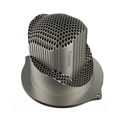

Fisher Cavitrol Hex
Fisher Cavitrol Hex
Justin provided an overview of valve sizing for applications with cavitation. To mitigate and eliminate cavitation three strategies include resistance, isolation and elimination. Isolation is breaking up the flow into separate streams via a Cavitrol valve cage. Elimination is taking the pressure down in steps where no steps drop the pressure below the fluid’s vapor pressure. The Cavitrol Hex was possible to create with the advent of additive manufacturing—a 3D printing technology using laser powder bed fusion.
It breaks up the flow in smaller streams for Veeball valves and can be used in dirty service applications. Different cavitation solutions include Fisher Veeball + Rotary Attenuator, Veeball + Cavitrol Hex, and ET + Cav II 1-Stage NP56 & NP58.
Mike shared the Ponca City refinery case study. They were having serious cavitation, vibration and noise issues causing the spool pieces to be constantly replaced. When they added the Cavitrol Hex they have not had any problems or needed to replace these spool pieces over three years. Since that success they have added the Cavitrol Hex to other valves in the refinery experiencing cavitation. Since these replacements in 2019 they have experienced no downtime or cavitation and vibration issues.
