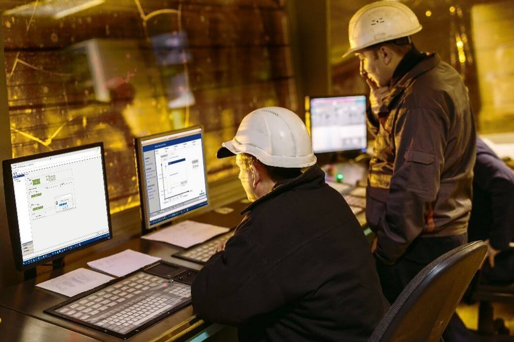

The latest non-contacting radar level gauges can be proof-tested safely and remotely from the comfort of a control room:
…using powerful and easy-to-use inventory management software. Built-in functionality guides an operator through inputting a straightforward sequence of settings and commands from their interface, enabling a device to be proof-tested in under five minutes. This achieves considerable benefits in terms of reducing risk and errors, saving time, and increasing worker safety and efficiency.
Caption: The digital technology available in modern level measurement devices enables operators to perform partial proof-testing remotely from the comfort of the control room.
