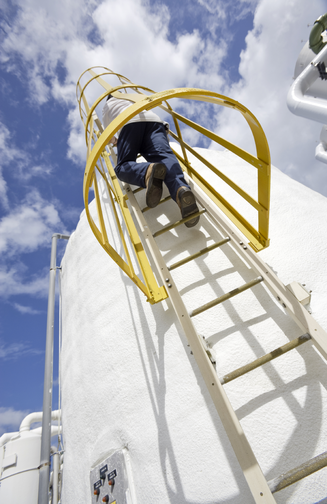

Proof testing has traditionally occurred on location but the digital technology available in modern level measurement devices enables partial proof testing to be performed remotely. The article states:
…the devices remain installed while simulated overfill conditions activate the detector and generate an alarm signal. Use of simulation makes moving fluid into and out of the tank to conduct the test unnecessary and avoids the risk of spills. It also eliminates the need for workers to climb tanks or be exposed to tank contents, thereby increasing their safety and freeing them up to concentrate on other value-added tasks.
Remotely performing partial proof testing eliminates the need for workers to climb tanks.
