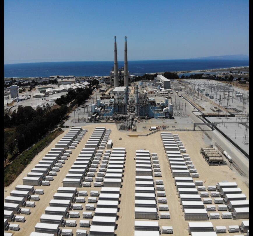

“You cannot approach renewables projects with a fossil mindset…At an old fossil plant you might have 20 Ovation controllers, with 3,000 hardwired I/O, and a bunch of servers. You get to a renewables site, and you’ve got one server and one OCR pair, and a whole bunch of data lakes.”
And he’d know. At one Vistra site, they’re managing millions of tags. That massive number of tags generates an even more massive amount of data—so much that the team could never hope to analyze it manually. While Vistra’s massive data pool may be uncommon in the industry today, it won’t be for long. As more and more producers expand their renewables offerings, they too will need to find ways to use enormous datasets.
