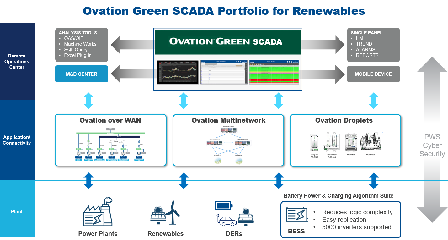

He next discussed the Ovation Green SCADA portfolio for renewable energy sources. Key parts of the portfolio include remote operations and application & connectivity flexibility to address the wide range of traditional and renewable plant and asset types.
Ovation Green SCADA Portfolio
