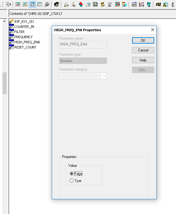

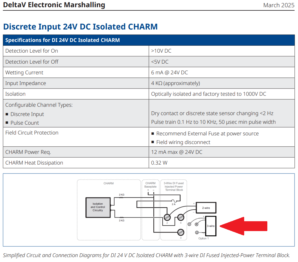

CPChem tips: One way to measure RPM, pulse count, frequency, tachometer, etc.
This example used a Hall Effect sensor to detect teeth on a steel gear. The CALC block is needed if your gear does not have exactly 60 teeth (60 pulses per revolution).
NOTE: Must use the isolated DI CHARM and must use an injected power terminal block.

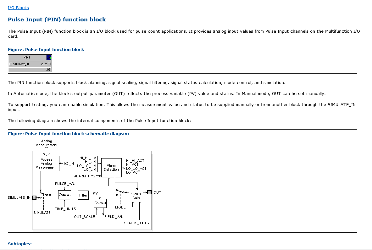

 Trouble Reading RPM with and I.S. DI NAMUR CHARM
 How do I configure a PIN (Pulse Input) function block for shaft RPM.
