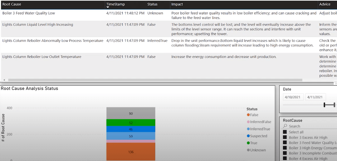

Plantweb Optics Analytics root cause analysis Another key element is root cause analysis which identifies suboptimal performance, the impact of the issue, and why it is suboptimal. For example, if a boiler is not operating at optimal performance levels, not only is the problem flagged and communicated to the right staff members, but also the source or sources of the problem and suggested corrective actions.
