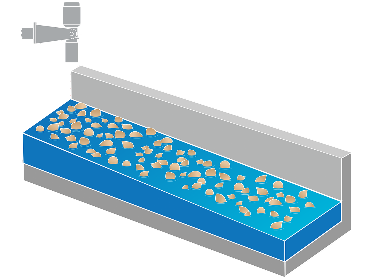

In the beet handling stage, the main goal is to minimize operator interaction and increase safety. Using level measurement technologies in the flume can help ensure the water level remains consistent while avoiding overfills. The Rosemount 1408A Non-Contacting Level and Flow Transmitter can be mounted easily above the flume and provides reliable and accurate level measurement.
Additionally, the Rosemount 2120 Vibrating Fork will provide point level detection and ensure that the flumes do not overflow by delivering level alarms when reaching critical levels.

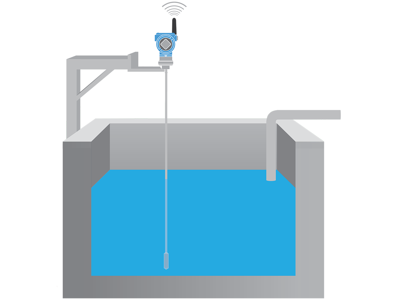

Wireless Remote Monitoring Technologies Increase Efficiency in the Sugar Washing Phase
Rosemount Wireless Technologies monitor level, temperature and flow in holding ponds and will help to minimize manual rounds at sugar processing plants. Additionally, wireless instrumentation is suitable for use in areas with limited power. The Rosemount 648 Wireless Temperature Transmitter offers best-in-class wireless accuracy and stability for process monitoring, and the Rosemount 3308 Wireless Level Transmitter enables automation of level measurements without calibration, apart from being immune to changing process conditions.

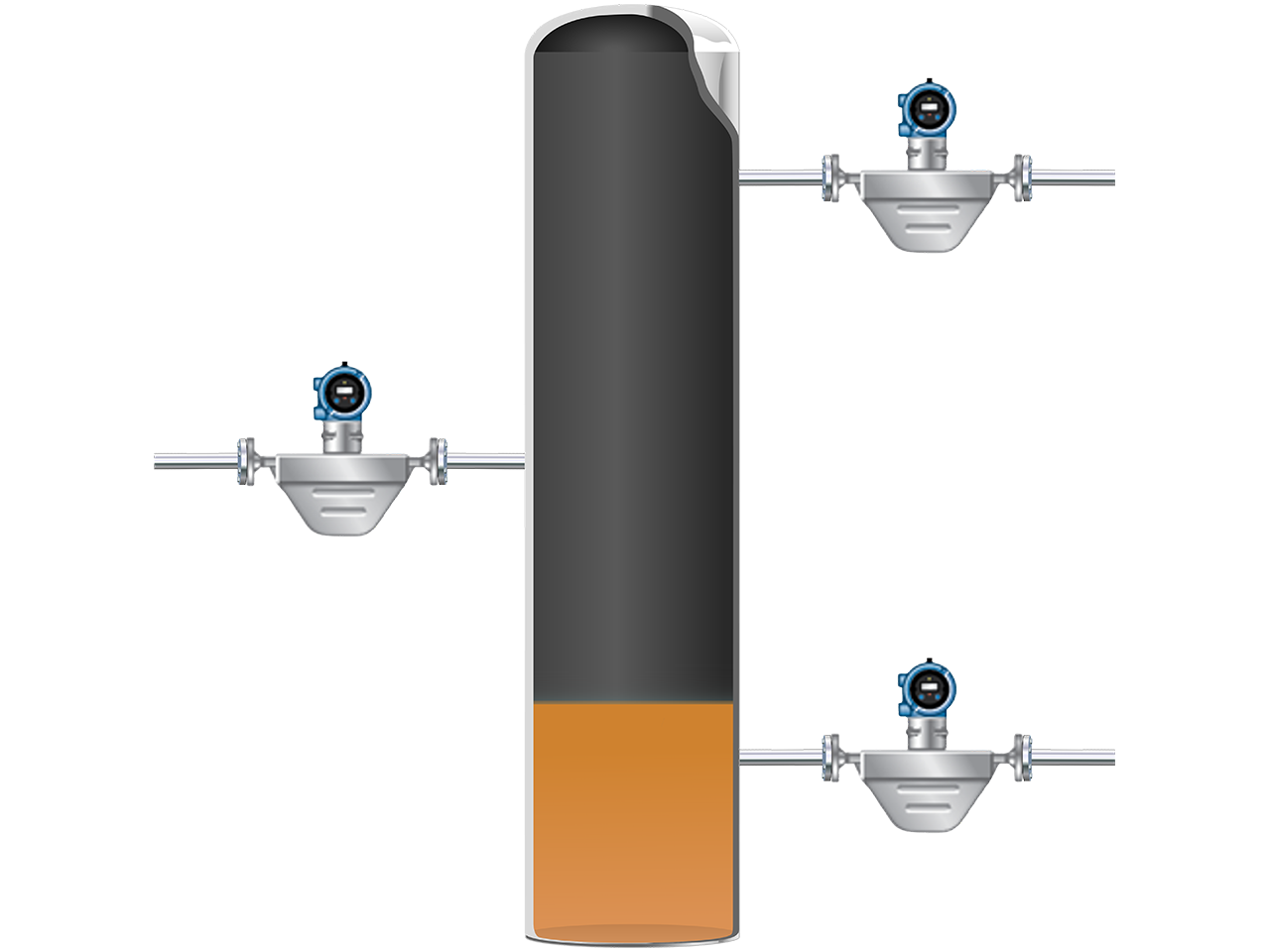

Flow Measurement Optimizes Sugar Purification Process
Coriolis meters are used in the purification stage to monitor mass flow and density in the Lime Kiln, so that it is possible to know how much Milk of Lime is added into the process. The Micro Motion Elite Coriolis Flow and Density Meters are perfect for this application, since they have been designed to deliver accurate and repeatable flow measurement, and they also come in the widest variety of line sizes and materials.
In the purification process, the sugar water (raw juice) has to go through several purifying and filtering steps to remove as many impurities, solids and fine particles as possible. The separation tanks from this stage can have numerous flowmeters to monitor the flow of the raw juice or the amount of waste that is being removed from the process. The Micro Motion F-Series are compact, drainable Coriolis Flow and Density meters that deliver highly reliable and robust measurements.

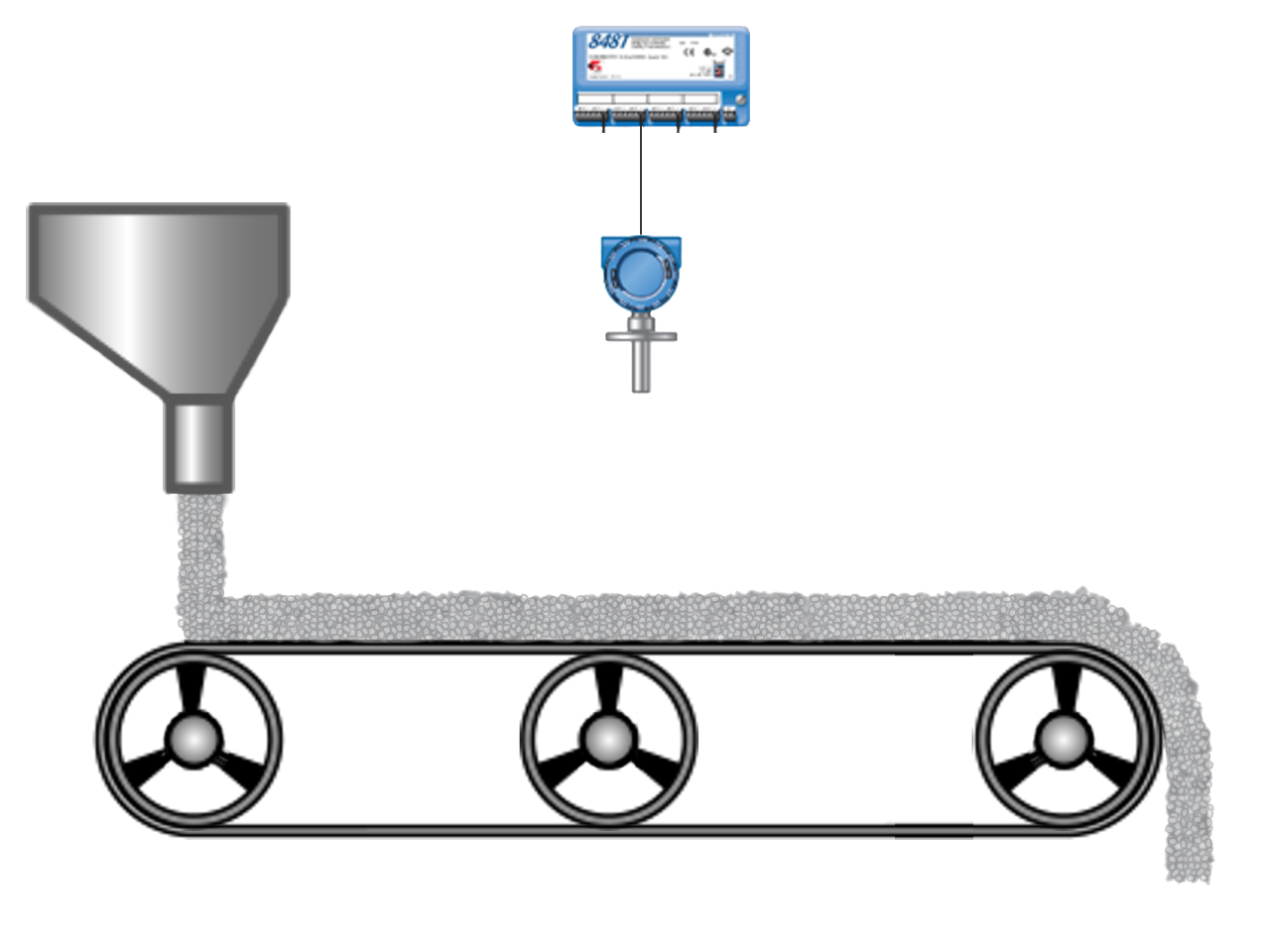

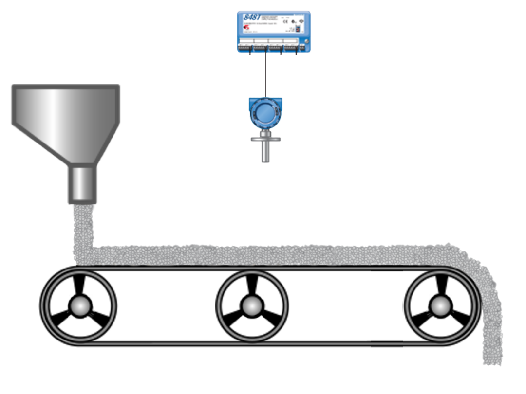

Temperature Measurement Increases Safety in the Sugar Handling Stage
The step after purification is sugar handling, where the sugar dries and cools down with air ducts to blow air for drying. In this stage, temperature control is important to ensure proper drying. The Rosemount 214C RTD Temperature Sensor will help to measure temperature with a high level of accuracy. The temperature measurements can be sent to the Rosemount 848 Temperature Transmitter to avoid any safety issue on conveyor belts.
