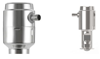

To meet the need for highly accurate and reliable level measurement in hygienic applications, Emerson has developed the Rosemount 1408H Level Transmitter, the world’s first non-contacting radar device designed specifically for the food and beverage industry. Dedicated features include a hygienic compact design, fast sweep technology, exceptional radar beam focusing and IO-Link communications, helping manufacturers to optimize the efficiency of their operations, reduce product losses and ensure food safety.
The world’s first non-contacting radar device designed specifically for the food and beverage industry (the Rosemount 1408H Level Transmitter)
Non-contacting radar is an ideal level measurement technology for applications that require stringent hygienic facilities and equipment. It is virtually maintenance-free, which helps it to ensure long-term reliability, in sharp contrast to legacy technologies. It has a top-down installation that reduces the risk of product loss through leakage, and it is unaffected by process conditions such as density, viscosity, temperature, and pH. The compact and robust form of the Rosemount 1408H makes it a suitable solution for the small tanks and space-constrained skids commonly used in food and beverage production. The hygienic antenna is flush with the process connection that ensures the removal of process residue during clean-in-place and sterilize-in-place processes and is insensitive to condensation and build-up. The hygienically approved, IP69-rated device has a stainless-steel housing with minimal crevices to withstand external washdowns and ensure cleanability.
The Rosemount 1408H is the first non-contacting radar transmitter with connectivity to the IO-Link communication protocol, making it easy to integrate with any automation system. The transmitter provides both conventional 4-20 mA, switch outputs and digital high-speed communication. It features innovative technology and smart algorithms to ensure installation and commissioning are made easy, saving time, and helping ensure trouble-free operation. Together with the new Rosemount IO-link Assistant software, which sets the parameters via IO-link, the experience of using Rosemount IO-Link devices is enhanced even further.

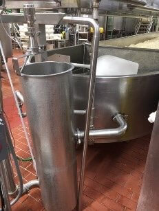

The 1408 Level Transmitter Reliable level measurement during and after cleaning (CIP – Clean in Place), plus optimization of cleaning agent storage.
The 1408 Level Transmitter ensures correct filling and storage levels in tanks with agitators in Dairy & Food Beverage Operations
