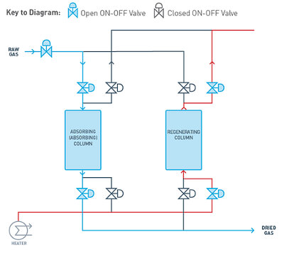

Molecular sieves are made from a micro-porous material to selectively adsorb gases and liquids. They operate in an adsorbing (purification) mode and a regeneration mode, which recovers the solid and liquid molecules trapped during the adsorption phase. The regeneration mode uses large swings in temperature to free the trapped molecules.
This process switching between adsorption and regeneration is very hard on the valves controlling the flow, due to the frequency of on and off switching. Failure of a valve can affect safety, emissions and production.
Molecular sieve column pair in adsorbing & regenerating modesTypically, adsorption columns come in pairs where one operates in adsorption mode while the other regenerates. They may cycle back and forth 24 cycles per day with thermal cycles up to 600°F/315°C. Beyond the frequent cycling and thermal stresses, the valves can be exposed to corrosive gases and residuals in some non-pretreated gas applications.
