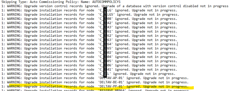

I need a Test system to program, and do FAT.

I 've created a new DB and import .fhx eport. at the end of import errors appears and the listed Controller and Station are not imported.
Where does the problem come from ?
How should I proceed ?
Thank you for support.
  • I would advise that the ‘Include the data for a DeltaV software upgrade’ checkbox be selected during the database import.
  • Those are Warnings, not Errors. Do not worry about upgrade warnings on a simulate machine. Are you sure the nodes did not import? Try F5 key or close and reopen DV Explorer.  If you do not open Explorer fresh, the nodes usually show at the bottom of the list, not in alphabetical order.  If they are truly not there, then you need to look at the import log again. Look for Errors. Especially ones that say Skipped for the node names in question. It should tell you why they were skipped.
