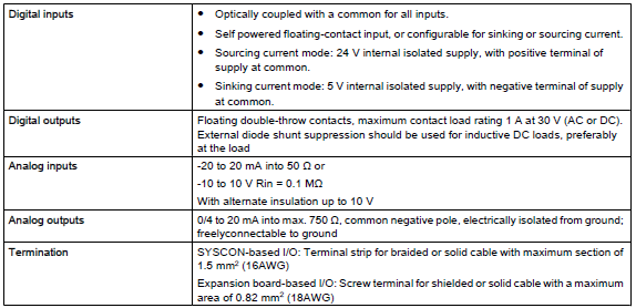

How to bring in the data from Siemens Analyzer Model MAXUM into DeltaV 13,3
Hello,
Does anyone know how to do the task per subject. If yes, then could please post step by step instructions.
Thanks.

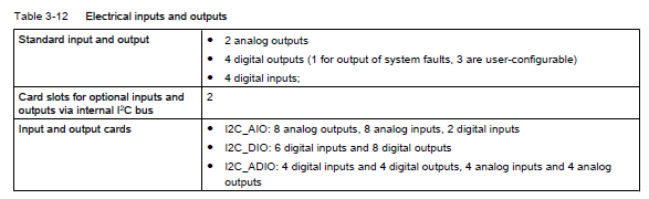

  • Can you provide more information?  For example, what type of data are you wanting to bring in and how do you want to transfer that information?  The user manual I found for a Siemens MAXUM II Gas Chromatograph shows many I/O options (discrete, analog, I²C, serial, Ethernet).  All of those except the I²C (and possibly Ethernet...it depends on protocol) can be pulled into DeltaV using traditional I/O and/or an EIOC.
    Lastly, if you contact the manufacturer or the vendor of the equipment, they might have experience doing whatever you are trying to do.
    https://cache.industry.siemens.com/dl/files/550/42017550/att_98342/v1/2000596manual_53_ID_42017550.pdf
