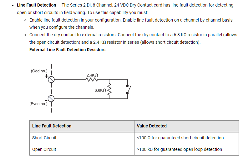

We are planning to use the 8-channel, 24V DC, Dry Contact cards for an upcoming project since we require circuit fault detection.
The data sheet says this card offers fault detection with a field resistor pack but I cannot find any details about the resistor values for this pack.
Does anyone have the requirements for this field resistor pack when using a set of dry contacts as the input?
Does Emerson sell their own resistor pack?
