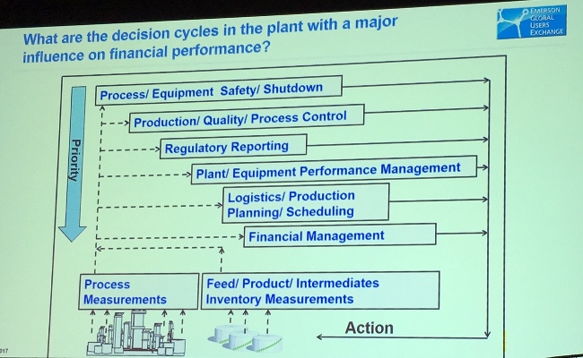

The plant decision cycle—measure, analyze, predict, decide and implement and this cycle repeats continuously. The priorities and decision cycles revolve around these levers of financial performance:
Plant Decision Cycles
