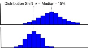

Data Reduction DistributionA second method is the data reduction method where raw data is collected over an appropriate time interval—hourly averages by shift, daily averages, etc. Remove and startup, shutdown and upset data. Normalize this data to a production rate. Plot a histogram. Subtract the values at the median and the 15% points. The differences indicate potential economic benefit.
The third method is the same limit violation methodology. Evaluate current variability and % limit violation. Then, reduce variability with good control (for benefit estimation, 50% reduction in benefit is a reasonable basis).
Based on statistics, calculate the allowed setpoint (SP) shift that will result in the same % limit violation. Calculate value from the SP shift.
