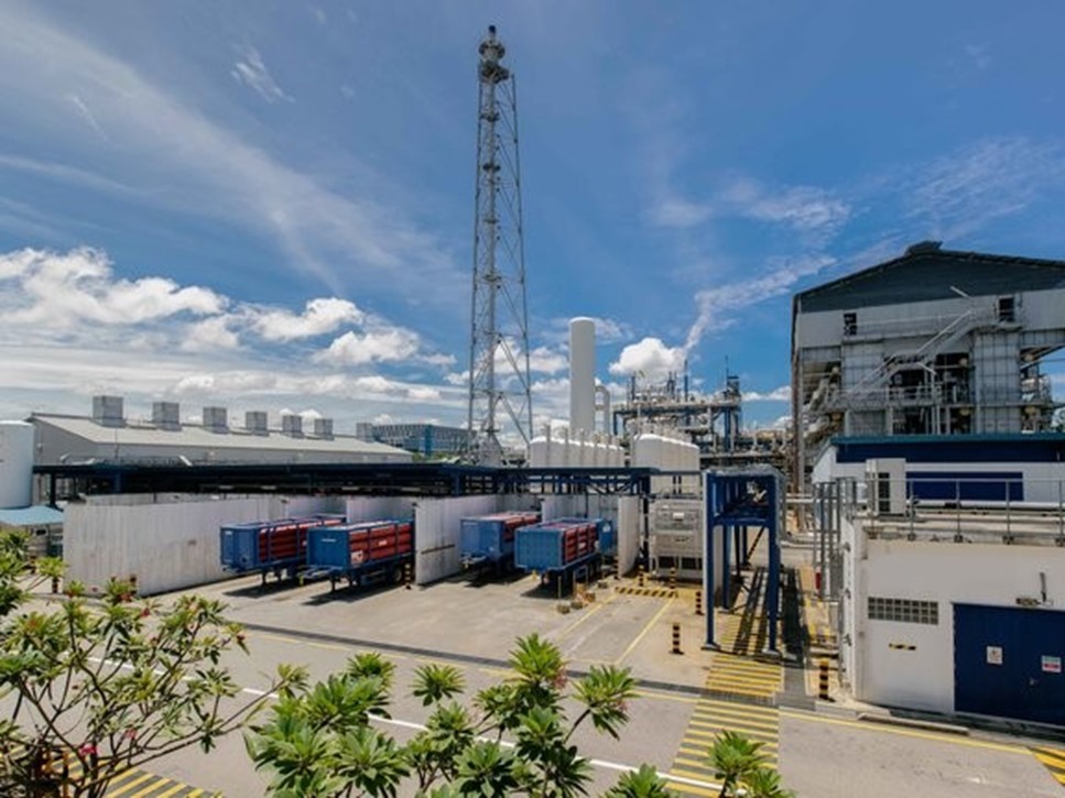

Figure 1. An exterior view of the gas plant, like the customer’s site, that would supply gases to the main plant from the utility wing of the plant.

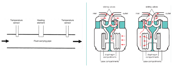

At the time, the facility was using diaphragm gas meters and thermal mass flow meters, both of which produced unsatisfactory results. Thermal mass flow meters required gas-specific calibration and were only suitable for clean, non-abrasive media with known thermal properties. These devices also came with high capital expenditures. Diaphragm gas meters, which use mechanical components, required regular maintenance and were generally limited to smaller pipes operating at low flow rates and pressures.
As a result, the plant experienced significant downtime due to the need for annual audits and calibrations. These limitations prevented the implementation of predictive maintenance strategies and restricted the range and flexibility of their flow measurement process.
Figure 2. Working Principle of the Thermal Mass Flowmeters (left) and the Diaphragm Gas Meters (right) that resulted in poor accuracies during audited calibrations.
