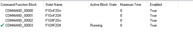

Are command driven steps ever supposed to complete? I'm working on a command driven SFC now, and when the SFC gets to the Termination (expression is "TRUE") it just remains on the last Step and the Command Step is forever Running. Am I missing something?

    Great question. No, it is an inactive (ACTIVE = False) step. I don't know if this is relevant but the Module level parameter "ACT_TRANS" shows "T_FINAL,T_OUT_00002". Not sure why it would indicate two active transitions. The second one seems to correspond to which command is Running (i.e. 00000,00001,00002,etc.).

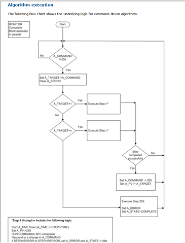

    There is an internal SFC that controls the execution of each command that I believe the ACT_TRANS parameter is pointing too. I'm glad you got your issue sorted out!
