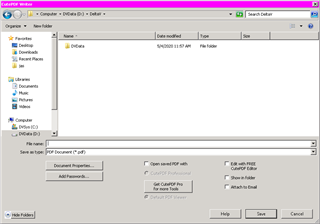

Wanted to reach out to group and ask if someone has used CutePDF application as a printer for Deltav system. I was trying to find a simple pdf printer that we could use and CutePDF gets the job done pretty decently till the time we are on windows desktop but having issues running it on operator stations on deltav desktop.
When Print is selected with CutePDF writer printer, it launches the CutePDF writer application but the application windows shows up on the windows desktop and cannot be accessed by operators.
I tried contacting GSC and see if they can help with having the CutePDF application run the deltav desktop but since this is an unsupported application, not much luck
So thought I will ask if someone has used the application and if so, what can we do so that window below is displayed on the deltav desktop when printing using the CutePDF writer (printer)

i agree it works great on windows desktop and the purpose here is not for graphics but for reporting from infobatch wherein a report can be printed from web interface launched from operate and saved to a shared network location

We know that any application not tested by Emerson is not supported but since you are willing to use CutePDF, can you use Foxit Reader instead? Foxit Reader installs a PDF print driver as well.
If Foxit is OK for you, you have to configure it for silent printing.
Steps to get it to work:
You should now be able to print from DeltaV Desktop and save the pdf into a shared location.
Again, this is not a supported setup ... have fun.
