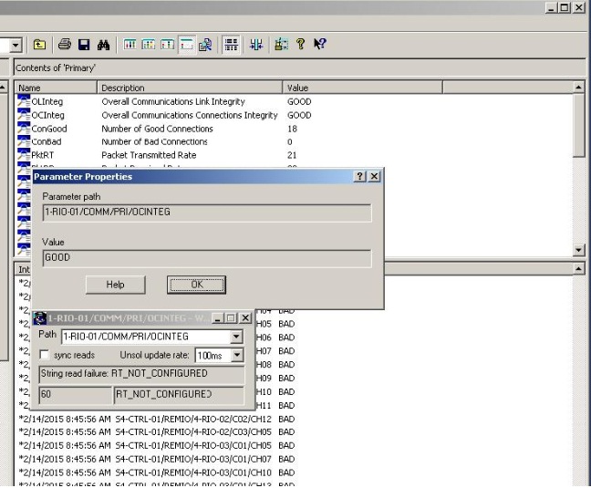

Does anyone know what would be the parameter paths for browsing the Comm parameter of the DeltaV Zone 2 remote IO nodes & Exist parameter for its cards.
If we look at the the below Snap shot, I was able to browse the Exist parameter of a card for the Remote IO node just like the card of controller. But it gave  ***(parameter not configured) error. See below left side.
For the Comm parameter of the Remote IO node I manually entered the path(Not Browsed) just like the one which is available for the controller. But it does not resolve & gives error ***.

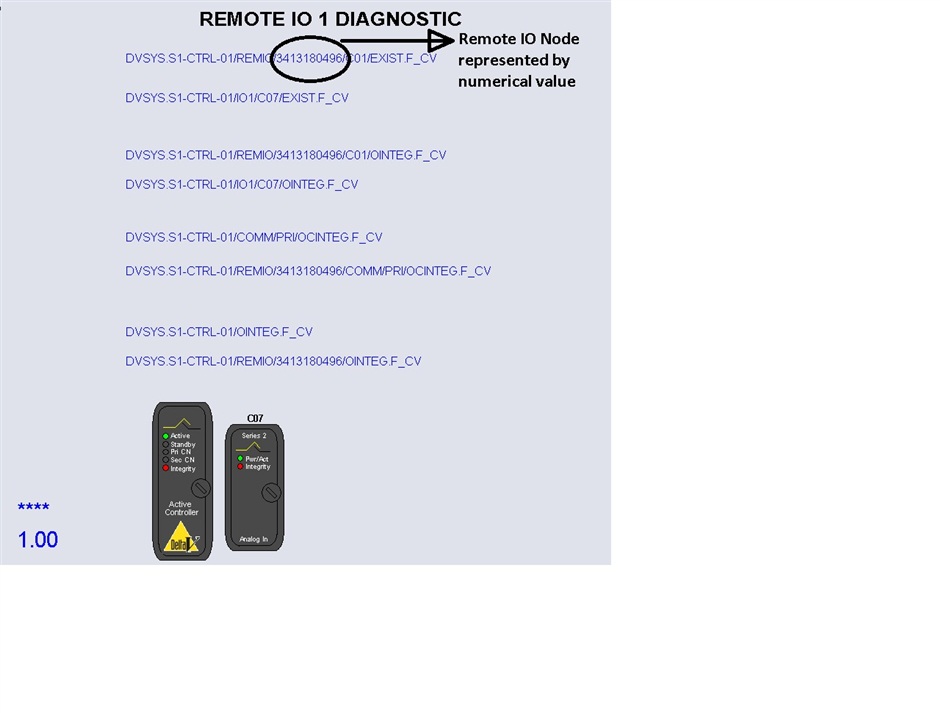

I would like to know what is the parameter paths to browse the Comm parameter for PRI & SEC links for a DeltaV Remote IO node & Exist parameter for the cards. I need this to show in graphics just like we have graphics for controllers & its cards.
PS:  The browsed overall integrity parameter path for cards of remote IO works just like cards of controllers.

  • Have you tried Right clicking the parameter in Diagnostics and selecting 'Properties'?  This opens a dialog with the appropriate path displayed.  Next, try that path in  Watchit.exe.
    I don't have Remote I/O to test this with, but give it a shot if you haven't already.
  • In reply to Youssef.El-Bahtimy:
    Youssef
    I checked the path in watchit as well as in graphics. Attached is the snap for watchit. In graphics I got &&&&.

    After some additional research, I've learned it is unfortunately not possible to reference these parameters, by design.  You may submit your request for an enhancement to this design at the User Driven Enhancement Program

    Thanks for the reply, I was hoping that maybe after 7 years and/or version updates this might have been corrected. Seems silly to have the parameters viewable in diagnostics for the node but not accessible via Operate. Is it possible to access them in Control Studio? You mentioned linking to assigned I/O for each card. I suppose I could look at each card via control studio and do the logic to presume the comms are good or bad for the node. Then I could display that for my operators and technicians. Is the path what is shown above, where just have to figure out the meaning of the 10 digit number?

    Some parameters are available at the workstation but not in the controller (module assigned to App station shows CIOC Temperature, but if assigned to controller, value is undefined). Some parameters are browsable while others are no. Some are simply not accessible. Hard to know which are which.
    Some parameters use the node ID, which is what 3413180496 appears to be. In this case, that would correspond to device 50, or address 10.4.0.204? Something you can check. The node ID number shows up in remote IO references via the controller, as opposed to a direct path using the IO Node name, may not be available.
    As Manzoor indicated, the properties tab shows the path as seen from Diagnostic Explorer. This will typically work from the Workstation in Watchit and Operate, but may not work in a module assigned to the controller.
