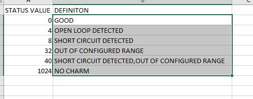

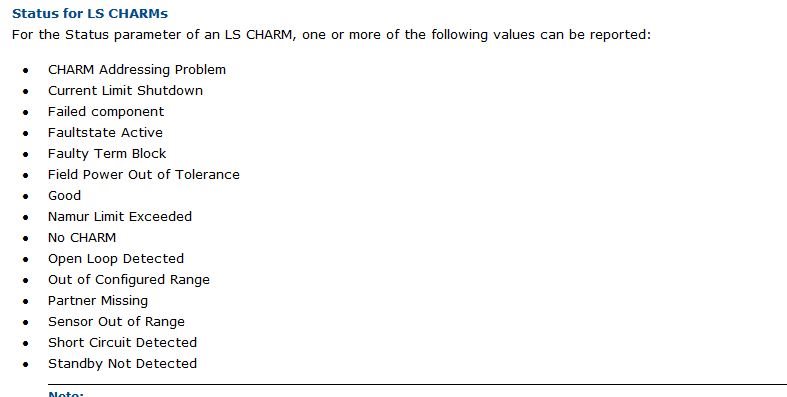

LS Charm Status over OPC reads
All I am reading Charm Status over OPC I have figured some out, but does anyone have the full list. This what I have found so far but want the full map.
