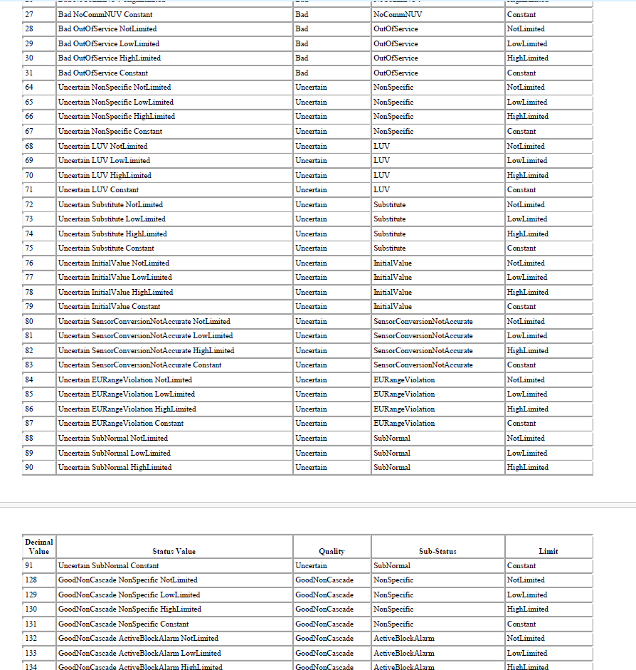

  • Not sure if this is the problem or not, but as a general rule... never use .ST = BAD. Statuses are an 8-bit unsigned integer where >= 128 are all various types of "good" and < 128 are various types of "bad". There is a table of all status codes in BOL. You need your comparison to be PV.ST < 128 or you can use PV.ST < GOOD as the constant GOOD=128.
    The lower bad value is worse, so it is common to use the following in a CALC block:  'OUT1.ST' := MIN('IN1.ST', 'IN2.ST');
    Edit: Added table screenshot.

    I would also suggest a few other changes if I were writing this code (keep in mind, I'm seeing the expression in a vacuum), but this very much looks like an interlock and a Hold in Man option from the AT block. This might be an alternative to doing custom logic in a calc block. Also, I just want to point out one additional thing. The last 5 lines can be written as OUT1 := ('^/PID1/PV.ST' = BAD);
    BAD as a constant represents .ST < 64. What's missing between 64 and <128 which is Uncertain.

    Using key words of BAD, UNCERTAIN or GOOD if fine. These define the ranges of Status, and effectively are looking at the 2 Status bits of the Status byte.
    The status of PV.ST is based on the incoming value for PV. The BLOCK Error will reflect an input failure, but that does not indicate a fault in the block. The fault is upstream on the PV Source, either AI block or IO reference.
    The PID Block has built in option to shed to MAN on a Bad PV, and coupled with an AI, an Uncertain PV can be handled as a Bad PV and trigger PID mode shedding to manual. This is intended to let the PID block hold its Output on a bad PV rather than possibly integrate due to an invalid PV (Fail Hi on Thermocouple burn out, or Low depending on process design).
