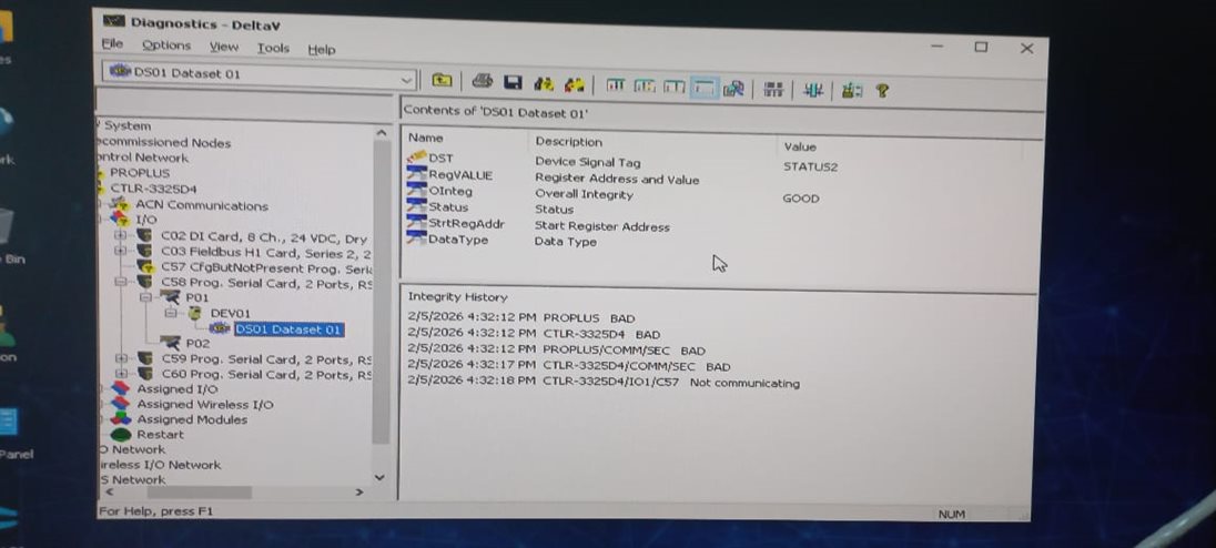

Hi guys.

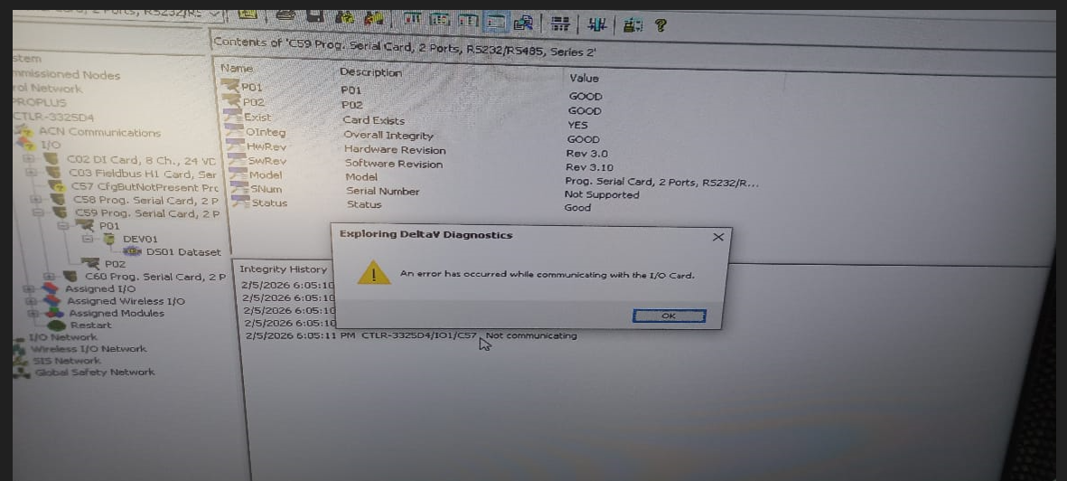

We have a DeltaV system where we perform practical tests. In this case, we're testing communication with a Mynah card (VIM1) in DeltaV software version 16LTS. There is communication between the Maynah Card and the controller, which is an MQ controller firmware 16. The problem is that when we simulate it in simulation software as if there were a device in the field, it doesn't communicate. In the diagnostics application, the card C57 appears with bad integrity and a message saying CfgButNotPresent Prog. Serial Card, as if it weren't there. But cards C58, C59, and C60 are good integrity. When we create a device on card C58, it doesn't communicate either. I don't know if you can help me with this, please. I don't know if it's something to do with the compatibility between DeltaV version 16 and Mynah card?
