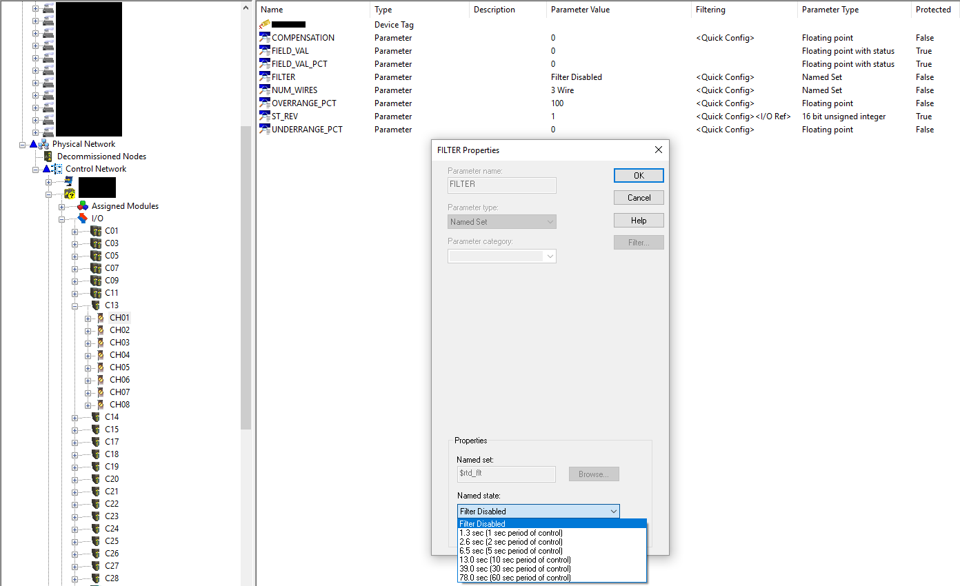

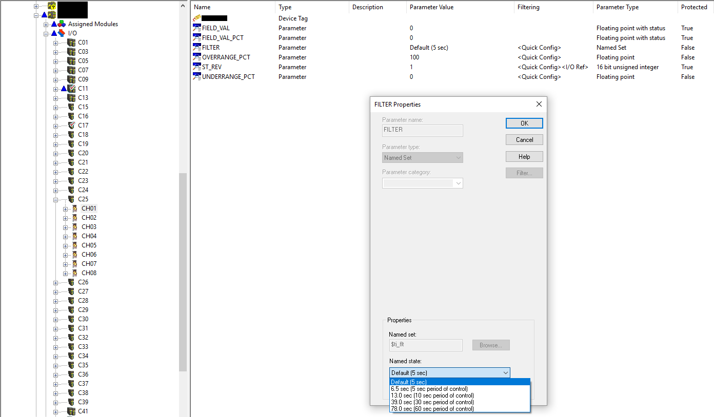

  • In answer to your question regarding filters.  In DeltaV Explorer, you can drill down through the controller to the specific channel that will receive the temperature and there is a "Filter" parameter that is NOT write protected.  If you double-click on that parameter, you can change the filter setting.  Unfortunately, as you mentioned, the lowest filter setting for thermocouples is five seconds.  The lowest filter setting for RTDs is "Filter Disabled".

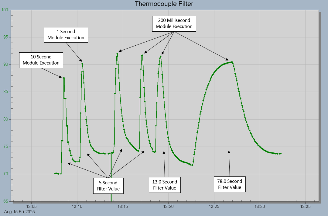

    According to Books Online, "The input value is averaged over the time specified.  The FILTER time must be larger than the effective scan rate of the block using the input from this channel or CHARM."  I did some testing (Type K Thermocouple), and the module execution rate didn't seem to matter if it was faster than the channel filter value.  I tried setting the module execution to 10 seconds, 1 second, and 200 milliseconds, with filter values of 5 seconds, 13.0 seconds and 78.0 seconds.  I used DeltaV Process History View to trend the data, and that is limited to one second updates, so the 200 millisecond execution rate won't trend properly.  Additionally, the response of the data from the filter was like a first order filter, where the time constant was the filter value.  To me this is different than "averaged over the time specified", but I just might have an incorrect understanding of the Books Online wording.
