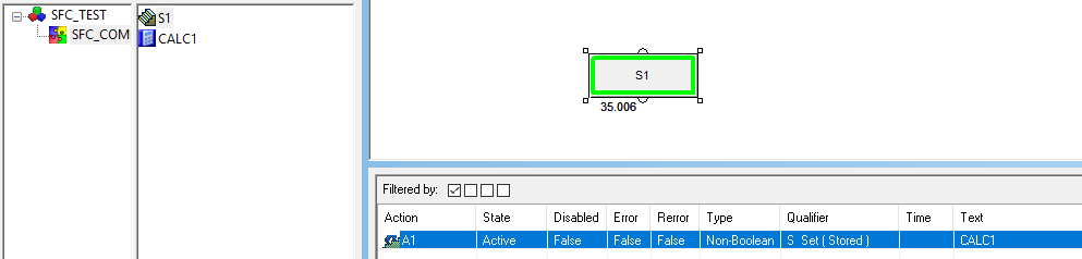

We created several Composite Templates of the SFC type, which include RET timers and CALC blocks for internal logic. The templates parse and download without any errors, and we are able to create Control Module instances from them successfully.
However, when we start these Control Modules, the RET timers and CALC blocks do not begin executing as expected.

You will need to have an action in your embedded SFC Composite start these blocks, below is an example of starting a CALC block to run.
In reply to Matt Stoner:
Matt,
Thank you so much for the quick reply.
It works!!
We also embedded SFC inside of SEC type of Composite Template with same issue. Now, it works too!
