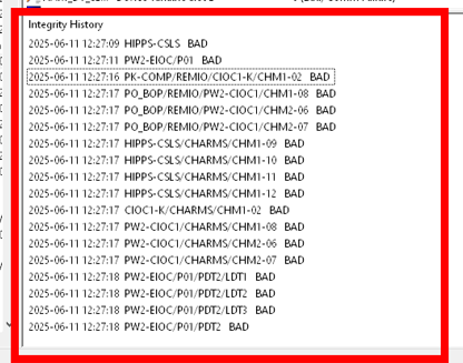

    1. The Integrity History can be saved
    The integrity History walks the DeltaV hardware tree and reports items that have a bad Integrity, including nodes, IO channels, Ethernet Ports etc.
    This gives you a list of all the channels with a path to go and gather more detailed in formation.

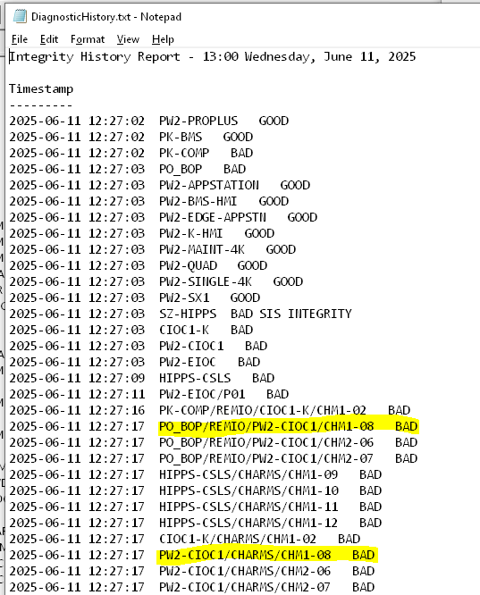

    By opening Diagnostic Explorer, and letting it complete its pass, you get a list of all items with BAD integrity reported. Notice that "PW2-CIOC1/CAHMS/CHM1-08" is also shown under the controller it is assigned to as "PO_BOP/REMIO/PW2-CIOC1/CHM1-08"
    Below is the text export of the history, with the CHARM 1-08 highlighted in both the Controller and the CIOC nodes.
    The CIOC Node;s channel path of PW2-CIOC1/CHARMS/CHM1-08 can be appended with the field "/STATUS" and you can read the diagnostic value in question:
    However, the Controller reference as shown in the History file does not work as written.  The CIOC name must be replaced with the CIOC's NODE ID
    PO_BOP/REMIO/306446346/CHM1-08/STATUS.  My point is use the CIOC based IO reference and avoid the need to know the Node ID number.
    Where am I going with this? If you used Excel, you could parse pass the Integrity History to an Excel Sheet, parse out all the IO channel paths and append /STATUS to them and read the current status of all BAD IO.  If they are not BAD, they are GOOD.
    On my system, I had 8 BAD CHARMS.  The other items were EIOC LDT related.  Which I could also get the /STATUS of those.

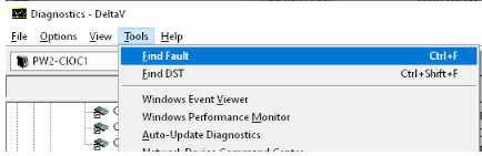

    2.  The other feature of Diagnostic Explorer is the Find Nex Fault:
    ;This quickly walks you through the hardware tree with Ctrl+F to quickly see what BAD status you have, instead of tracing the yellow question marks through the folders of the tree.
