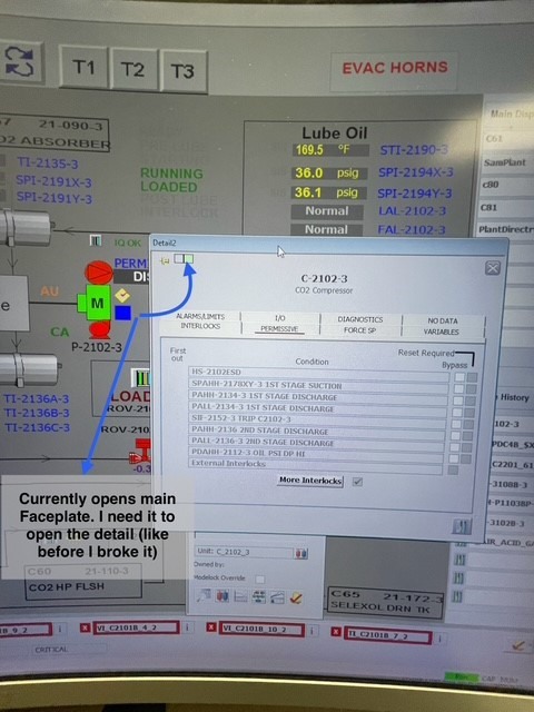

Im having an issue with a Dynamo. Operations wants the interlock active to show like it does in the valve dynamos. It has a l
ittle diamond with a check mark. The motor dynamo has a little blue box that also shows up on the faceplate.
My question is, how do I look at custom script? Clicking this little box opens the Faceplates Detail page, specifically the Interlocks.
I want them to be able to click this little check box just like they can the little blue box to pull up the interlock page. I cant find squat
on how to map a open faceplate to a faceplate detail. I tried making the script the same but I broke the link.
Thanks!
