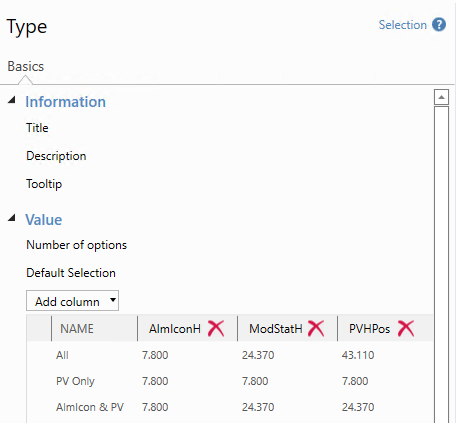

This is sounding like what I commented on earlier that you want to dynamically set the width of objects based on the database configuration...I played around with some of it but ended up just having the PV, EU, etc widths be a configurable width on the GEM and then do all the positioning based on those configuration items because the animations/scripts don't run at edit time so for the person configuring the GEM to know what it "might" look like at runtime it just seemed to be easier.
We have considered using a custom selector where you could choose the "option" and then you can add measurements to that selection (see below) and then link the object widths to those measurements...but with not fixed width font you have to find the "worse" case and use that width. Unfortunately I don't think you will find an "easy" way to satisfy everything (or you will spend a lot of time trying to get there and may never get to it).
