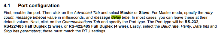

    Dave, the Enhanced Modbus Programmable Serial Card firmware was released in Jun 2021.  NK-1800-0392.  The KBA indicates the Time Delay setting in the Advanced Tab of the port.
    From BOL:
    Transmit Delay (ms)
    Select a value to determine the time the Serial Card delays between requests for input data and/or requests to write output data to the Modbus Device.
    This value is used to slow down Modbus master requests being transmitted to slave devices that require a time delay between requests.
    The default Transmit Delay value is 0 because most Modbus devices do not require any delay.
    Configuration dialogue:
    I believe the VIM has same delay option.  EIOC/PK modbus TCP does not have a delay option and polling cannot be adjusted.

    The max Transmit Delay allowed is 25500 ms (25.5 sec). It’s constantly polling. I need it to be more of a call or push scenario.
