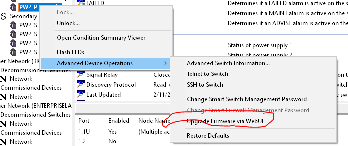

We have 6 DeltaV Smart Switches RM100 but 3 failed as shown in Network Device Command Center:
I'm afraid these 3 failed switches are properly commissioned. So how to decommission and recommission again?

I use Putty terminal emulator on my PC with USB converter. I have to check which comm port the usb converter is using and set that in the Putty connection before the CLI terminal session can communicate.
From Device Manager, I check to see the COM# used by the USB Converter
Putty is a freeware terminal emulator.
In reply to Andre Dicaire:
Hi Andre, Are you aware of a CLI command for the RM200 switches that is similar to "DeltaV default" for the FP20? The RM200 responds with invalid command in CLI. Thanks,Update: found that for RM200 the relative command is first "enable" then "factory config"
I discovered the same thing recently with a new FP40 switch. No DeltaV Default menu. Got some help from one of our Network Engineers to configure the Mirrored port.
I've since learned that there is a Web interface on the new switches that is supposed to provide an easier UI for configuring the switches. I have not explored this, but it would make sense to use that rather than build a customized CLI menu.
So there is more there than just Upgrading the switch. I'll have to investigate this a bit more, but clearly much more useful than CLI. There is still the full CLI switch commands in the switches, just no longer has the DeltaV set of settings.
You can set the Port mirroring here and much more.
