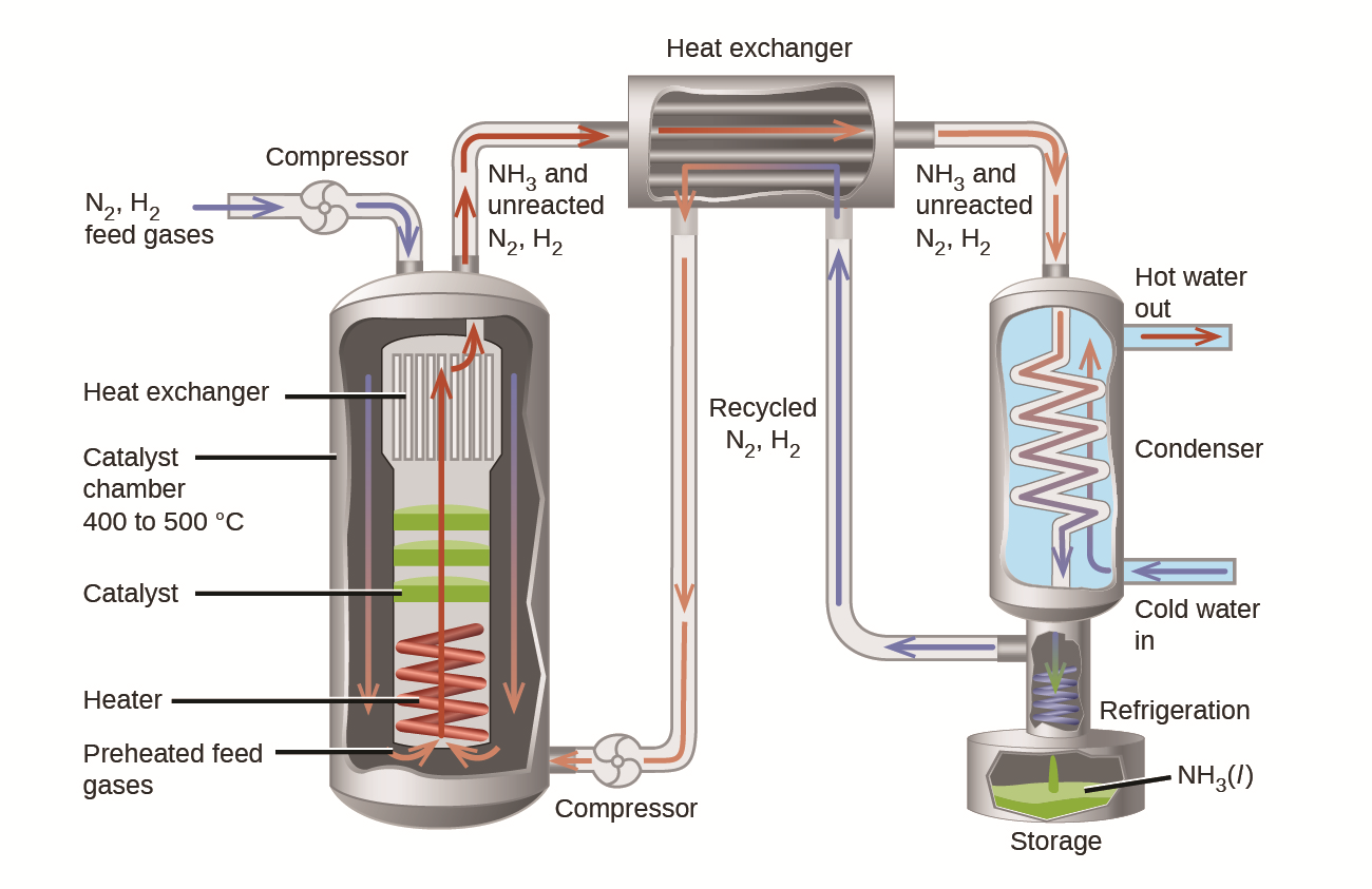

Ammonia production
Figure 1: Ammonia production from feed to storage – simplistic view. Click to enlarge

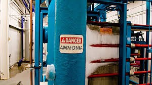

Ammonia hazard safety sign
Figure 2: Ammonia safety sign displayed in a hazardous area at a plant.
For ammonia plants, the main consideration is human safety. NH3 irritates the eyes, the nose, and the throat. In large concentrations, it can burn skin, damage lungs, and/or cause blindness. Measuring instruments must be able to endure these conditions as well. Ammonia is highly corroding, and extremely high temperatures are necessary to produce the compound. Over time, both conditions tend to damage standard apparatus, causing them to become defective – and the plant loses efficiency.

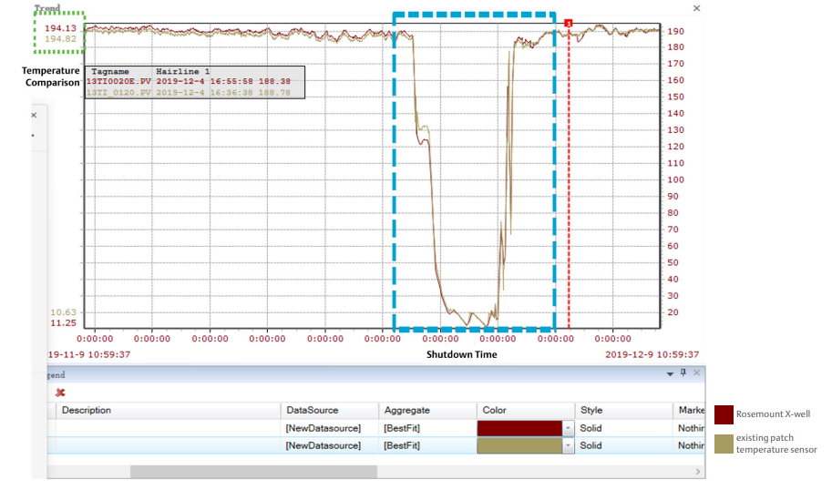

In the customer’s plant, ammonia flowed through the pipeline in the ammonia production unit in liquid form. A traditional patch sensor installed on the pipeline was used to measure the temperature, and data was then transmitted to the distributed control system (DCS). Temperature readouts range from 0 °C to 200 °C. Low level sensor signals from RTDs and Thermocouples are quite susceptible to Electromagnetic Interference (EMI), electrostatic Discharge (ESD), and Radio Frequency Interference (RFI).
Sensor leak can act like an antenna for noise interference causing a potential wide range measurement error. The system installed in the temperature loop suffered from large static compensation error resulting in inaccurate measurement readings at the control system. These inaccuracies also pose safety risks in the process unit. To prevent hazards, the management instituted a plant-wide policy to ensure that the readings on the ammonia pipeline is highly accurate. The challenge was to minimize temperature reading errors below its current range of +/- 1% of span.
Figure 4: A side-by-side comparison of the Rosemount X-well showing marked performance improvement at the DCS versus existing patch temperature sensor as evidenced by decreased noise/error and smoother curve. Click to enlarge
