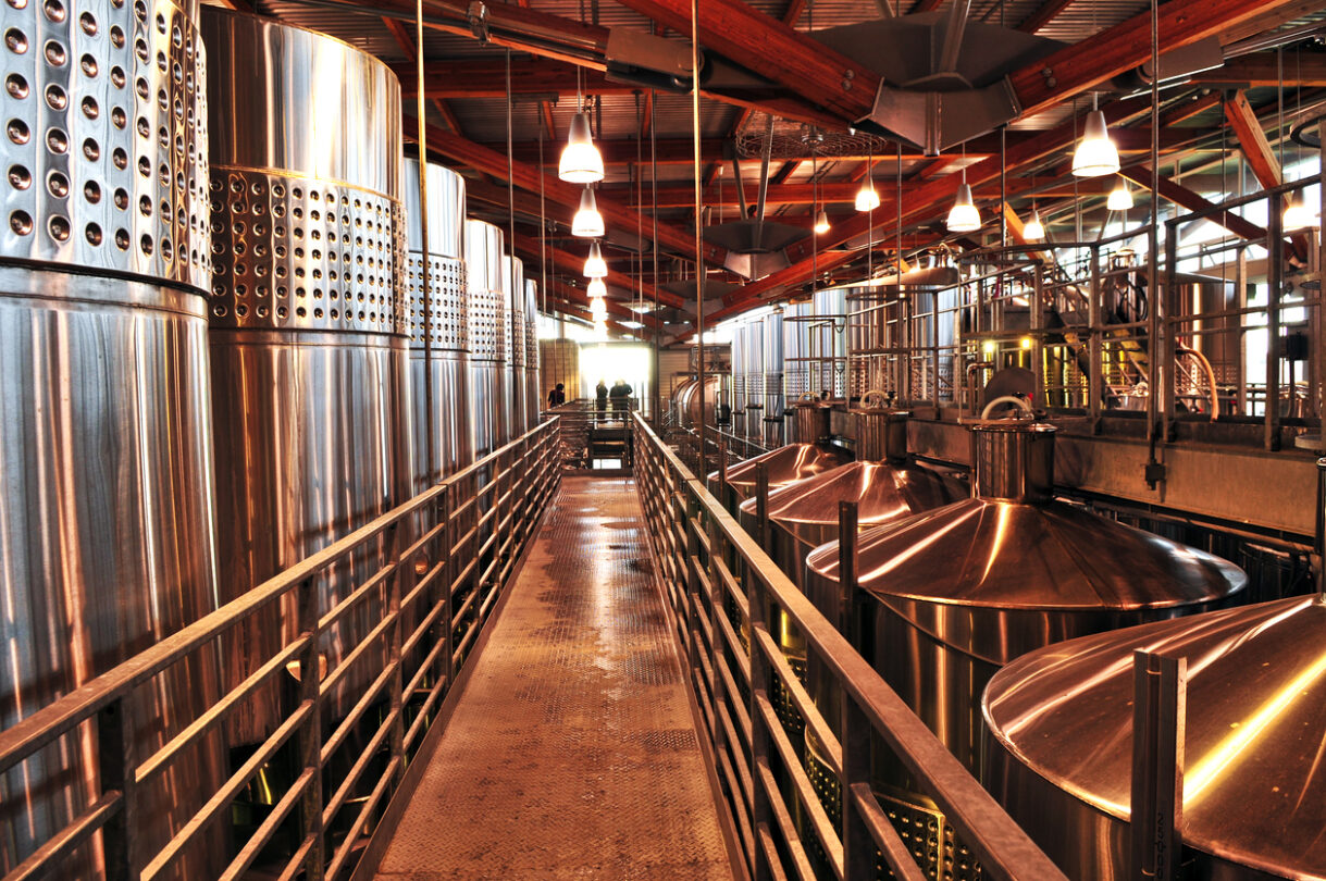

The key lies in the fermentation process, which requires precise temperature control to ensure quality, consistency and taste across various beverage styles and flavors. Optimum temperature control requires the right valve system to control heating and/or cooling parameters.
Alcoholic beverage producers typically control tank temperatures using glycol or ammonia systems. This nontoxic liquid media flows through thermal jackets surrounding the fermentation tanks. In a closed circuit, the glycol is pumped through a chiller, where it is cooled, and then flows back down through the jackets — cooling the tanks and their contents. Not only does temperature affect the speed of the fermentation process, but it also affects the taste and quality of the final beverage.
Because fermentation is such a vital process, it’s no surprise beverage-makers increasingly are looking to install or upgrade their tank cooling and heating systems. But these modifications don’t come cheap, nor without challenges. Many facilities, particularly smaller operations, have limited physical space. As a result, tank systems need to be positioned as close as possible to each other to maximize floor space and remain accessible during maintenance.
