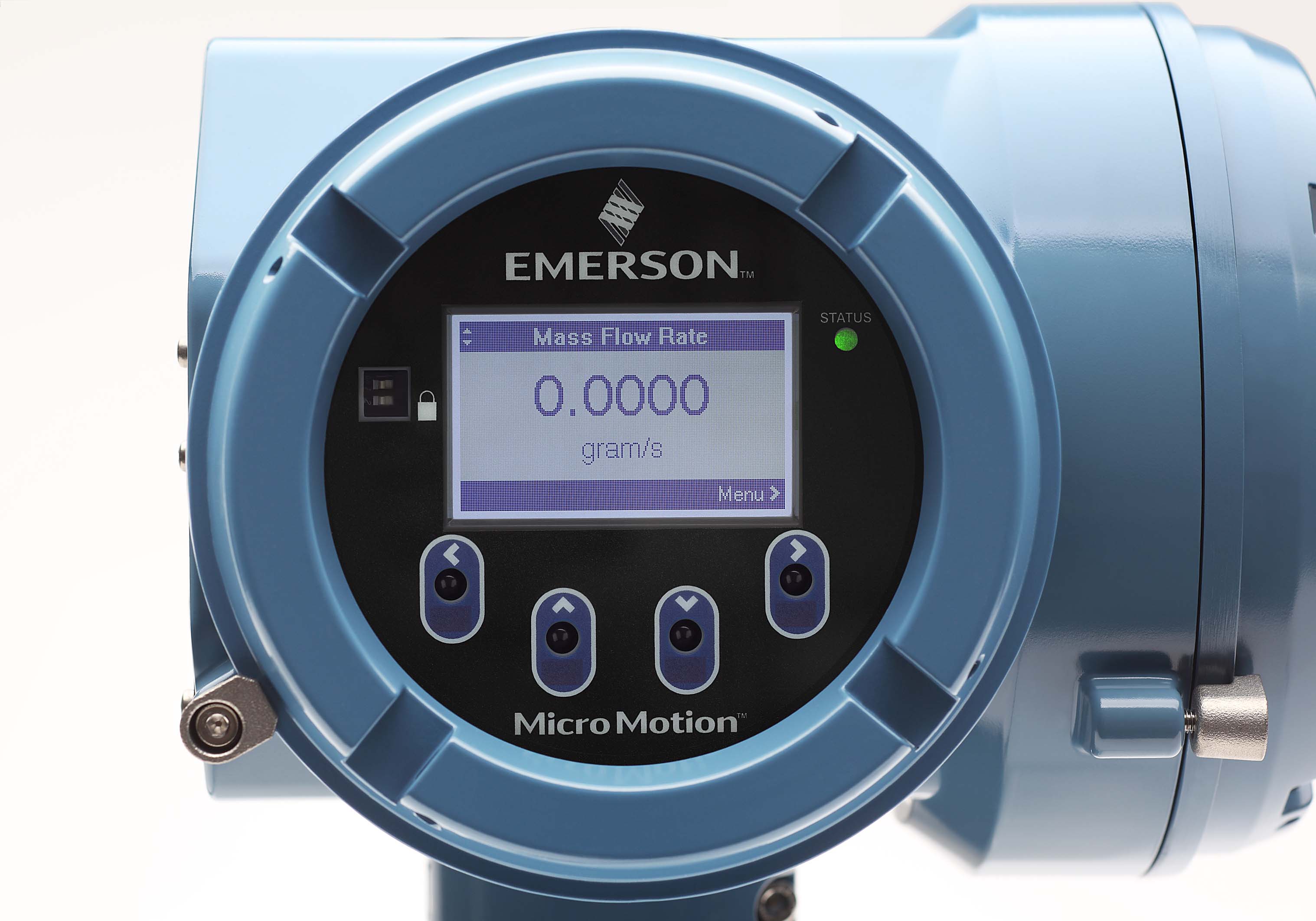

Emerson Process Management has introduced the Micro Motion Model 5700 Transmitter, a Coriolis flow transmitter designed to translate measurement data into meaningful insight and instruction. The Model 5700 is applicable for a broad range of applications, from liquid and gas custody transfer to simple process control.
“The Model 5700 transmitter was developed using Emerson’s Human Centered Design approach to technology innovation,” said Jason Leapley, product manager. “We performed usability testing to fully understand user information demands and real-world application requirements. Every feature of the Model 5700 was designed to reduce the time and expertise needed to install and operate the Coriolis meter.”
“The Model 5700 moves beyond just providing more data and instead focuses on delivering useable information to provide even deeper process insight from Micro Motion Coriolis measurement,” added Bill Graber, Emerson’s vice president of marketing for the Micro Motion business. “The result empowers customers to better leverage rich Coriolis measurement data in order to further understand and improve their operating environments and achieve new levels of productivity.”
The Model 5700 provides users access to detailed measurement history for troubleshooting or optimizing the process. The graphical user interface was designed for intuitive operation, with simplified installation, configuration, maintenance and troubleshooting. The new transmitter translates Coriolis measurement data into useful operating insight through robust, time-stamped history files for process and meter health data, and logs for configuration changes and alarms.
The Model 5700 digital signal processing architecture provides fast flow response time, making it optimal for custody transfer proving and short batching applications. The historian feature also improves Micro Motion Smart Meter Verification, which provides measurement of the full meter health without process interruption – improving measurement confidence and easing regulation compliance.
Compatible with new and previously installed Micro Motion ELITE Coriolis sensors, the Model 5700 has a field-mount design that is suitable with most hazardous area installation practices and with both integral and remote installation options. It currently includes options for analog, pulse, discrete and Modbus outputs and an analog or HART input. The Model 5700 and additional digital communication options will be available for other Micro Motion meters and platforms in the near future.
