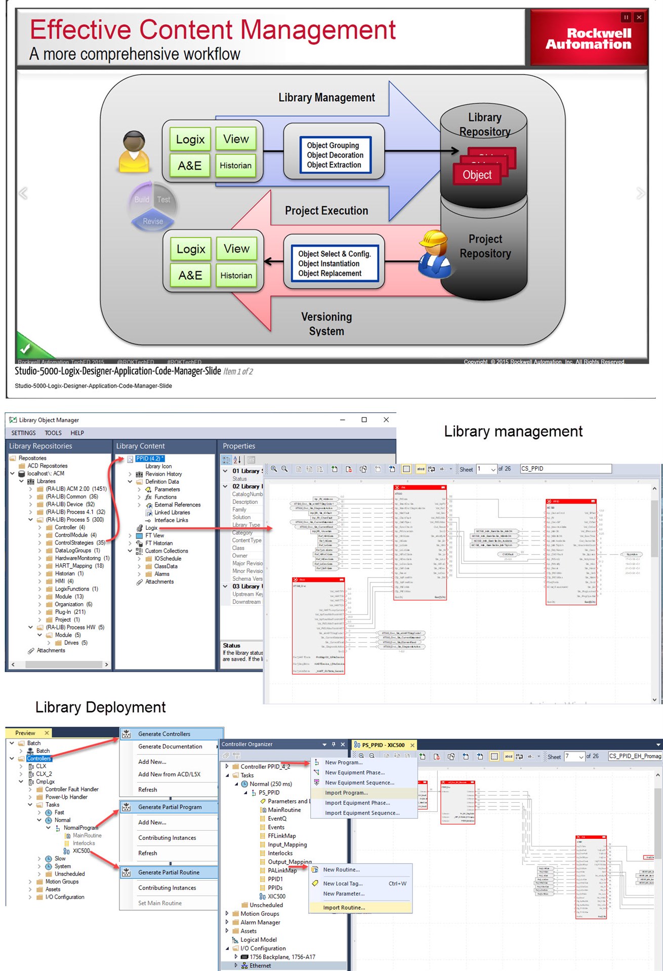

PlantPAx is has an object library. You can modify and deploy that library across multiple applications.
This slide below is from 2015 so it's not showing all the latest features but the object can contain:
For Logix... an example of a Process control strategy is the PPID... shown in the library on the left and the function block sheet is on the right. You could modify this control strategy and publish it back to the library as a new version for the PPID control strategy.
Once the library object is updated, you'll want to deploy those changes. In this example, we only changed the Logix so it is showing those deployment options. You can generate ACD files for all the controllers, however, this would require a scheduled time for the download. To deploy to a running system without stopping the controller, you can generate programs and/or routines L5X (that are impacted by the object changes) and import them to the running controller.
When importing the Logic to a running controller, the existing logic is still running and the new logic is imported along side the existing logic so that you can see both in the controller and toggle between both. You can test/untest/assemble the edits in the controller. Eventually you will assemble and finalize the edits where the new logic replaces the old and the old logic is removed. For the brave, you can skip directly to finalize edits which immediately overwrites the original logic.
Besides the Process Objects library, there are lot of other libraries available to download for from from the download center.. search for ACM or "Library". You can also build your own content and implement it with this same workflow.
