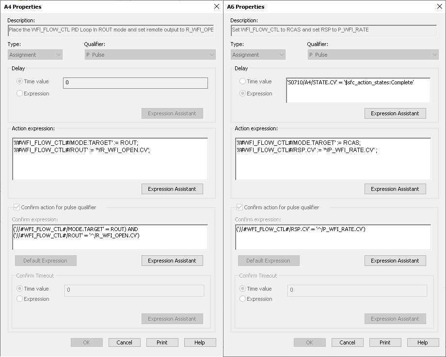

    Here's a screenshot of the actual actions for one area of our process. (It's slightly different, particularly the confirms, but is essentially the same method.)
    Screenshots of actions
    (Notes: R_WFI_OPEN = 20, P_WFI_RATE = 70, MODE = PID1/MODE, ROUT = PID1/ROUT_IN, RSP = PID1/RCAS_IN)
    So A4 sets the module to ROUT with an output of 20, and confirms that the target mode is ROUT and the target output . A5 waits for A4 to complete, then sets the module to RCAS with a setpoint of 70 (P_WFI_RATE = 70). That SHOULD have had the output start at 20%, then had the PID start controlling. But what really happened was that the PID1/OUT started at zero and slowly ramped up until the flow setpoint was reached. I've watched it happen twice in real time; the output really does start at zero and control up from there. Both the unit (that the phase is running on) and the module are on the same controller.
    If Matt Stoner is correct, it's possible that the ROUT_IN isn't getting fully set due to being in the same action as the MODE change to ROUT; if so, gamella's solution of splitting them into 4 actions would seem to work. Could we do the ROUT_IN first, then MODE:=ROUT and RCAS_IN in an action, then MODE:=RCAS? Or does it really need to be 4 separate actions?

    The AT connects to the PID Track inputs and would typically be used for interlocking the PID output, which sets the PID in LO. Managing the PID in normal control scenarios with CAS, RCAS and ROUT allows the logic to be developed without compromising the Interlock logic, that is, whatever you end up doing in this control application, the interlock stays ready to act as designed. It can get complicated trying to do both interlock logic on the output and manage control variations all in the AT block. It's possible, but it can lead to an overly complicated interlock solution rather than keep these things separate.
    The example above seems to be using module level parameters for the ROUT and RCAS values, which may be wired or internally referenced to the PID block parameters. That can change how the values are processed. The point Matt makes is writing to MODE.TARGET requires the block to execute before MODE.ACTUAL is attained. The write to the ROUT_IN or RCAS_IN needs to follow the MODE.TARGET attaining the desired mode. separating the mode manipulation from the parameter setting allows the block to accept the value as it has actually changed to the correct mode. If the target parameter is wired into the Block, the value will be sitting in the parameter waiting for the Mode.ACTUAL to change, and the value is then read. subtle timing issue that is avoided by sequencing the Mode change and then the parameter write once the mode is attained.
    DeltaV PID execution is designed to avoid SP induced bumps. Some blocks have balance times that kick in to also avoid abrupt changes. Normal cascade loops track the CAS IN value for bumpless transfer to CAS mode and once in CAS, the source PID block is released to now drive the SP of the second loop. A similar approach would be prudent moving to RCAS or ROUT that ensures the mode change is bumpless, and once enabled the RCAS or ROUT controls start to move the value as needed. SP rate or OUTPUT Rate limits may be in place to prevent sudden bumps on the working SP or OUT value. These will prevent a straight bump change if enabled.
    I totally agree with Matt that your MODE changes should be confirmed before you do your control parameter write. This way it matters not if the module has a wired parameter or internal reference or if you write directly to the block parameter. Always confirm the mode Actual is correct before writing. This can all be done in one Step.
