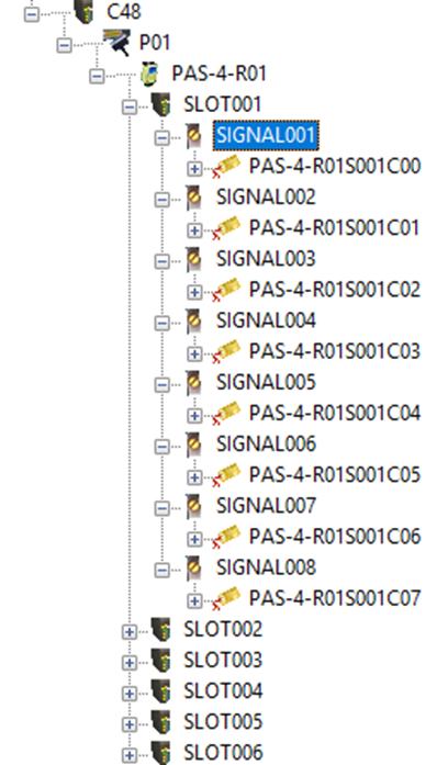

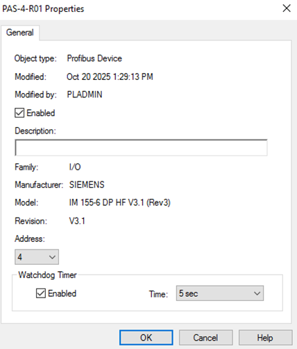

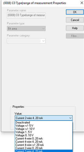

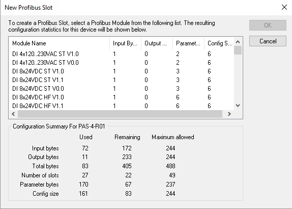

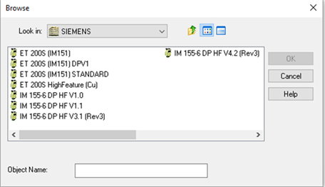

Yes, on DeltaV 14.3 The two pieces that tripped us up was finding the correct GSD files adding the "server module in the last slot" End Cap.
